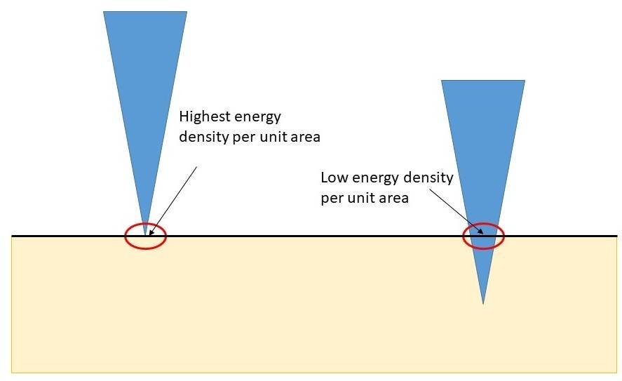

I know what ablation is, but maybe I didn't explain myself well..., Why should nothing really occur when the focus inside the bulk (material) far from the surface?

Were you never a naughty child who tried to see what would happen if you focused sunlight using a magnifying glass onto an bug?
Zz.

I used magnifying glass onto a paper it was so thin :P. It seems my question was not close to what I meant 🙈🙉🙊, anyway can you guess what will happen inside the bulk then?

Why should anything happen inside the bulk material if nothing happens on the surface? I'm assuming we're still talking about the ablation process. You have light in a material with a different index of refraction, and the material may also start to scatter the photons. Depending on the laser wavelength, it may just pass through without doing anything. But even if there's enough energy to cause vaporization inside the material, none of it will probably be released, or at least, it is not significant enough that this is how you want to do a laser-ablation process.
Zz.

1. It is key for laser ablation that the laser is pulsed with high peak power. If you would use a CW laser, the glass would melt instead. The focused, pulsed laser with high peak power doesn't melt the surface. Locally, the atoms in the glass are given so much energy that they enter the vapor phase and leave the surface. They don't give their heat to their neighbors because there is no time for that relaxation process. This implies that it is the peak power (W/cm^2) that is key for the ablation process, and it only works at the beam waist.
2. If the laser was focused below the surface, some would be absorbed above but there is probably still enough energy at the waist to vaporize. However, the atoms are stuck within the bulk and cannot escape. They cool, redeposit, and their energy is given to their neighbors. So all you're doing is heating/melting.
