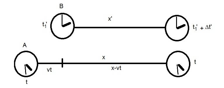

It seems I am also confused about synchronization. I defined the time origin t=0 as the instant at which frames A and B space origins are coincident, with clock X at frame A x. A synchronizing signal from the frame A midpoint x/2 reaches all three clocks simultaneously. Since this procedure is independent of x, one can have a frame with as many synchronized clocks as one likes. I understood from the previous thread that the time coordinate of a frame is that on anyone of these clocks.

A clock Xb, stationary in B, could be synchronized in the same way. Synchronization being an instantaneous procedure, velocities are irrelevant. The present question is however the B coordinates of an event stationary in A.
  • #36
No, it is not. If the third is stationary in A's frame, then it CAN'T be synchronized with B's clock.
An "event" is a single point in space and time. It's not stationary in any frame, because it's not an object.
Anyway, I've tried to explain to you how to compute ##t'## in terms of ##t##. Here's a picture of the situation:
The event with coordinates ##(x,t)## in frame A is the event that would take place at the end of a stick of length ##x## held out by A, and on the end of that stick is a clock, synchronized with A's clock, showing time ##t##. The same event has coordinates ##(x',t')## in frame B, which would be an event that would take place on a stick of length ##x'## held out by B, on the end of which is a clock showing time ##t'##. We arrange it so that when B's clock shows time ##t'##, A's clock shows time ##t##, and they are right beside each other. So ##(x,t)## and ##(x',t')## are two different coordinates describing the same event.
Shown from the point of view of A's frame, we can reason as follows:
  1. The distance between B and his remote clock is ##x'## in his own frame.
  2. The distance between A and his remote clock is ##x-vt##.
  3. Because B's stick is length-contracted, we have: ##x-vt = x'/\gamma##
  4. In A's frame, his remote clock is synchronized with his personal clock, right next to him. So they both show time ##t##
  5. In A's frame, B's personal clock shows time ##t_1' = t/\gamma##, because B's clock is running slower than A's by a factor of ##\gamma##
  6. In A's frame, B's remote clock shows time ##t' = t_1' + \Delta t'##, where ##\Delta t'## is the offset of B's remote clock, relative to B's personal clock.
So we have the following relationship between A's coordinates ##(x,t)## and B's coordinates ##(x', t')##:
##x' = \gamma (x-vt)##
##t' = t_1' + \Delta t' = t/\gamma + \Delta t'##
So we have our transformation, except that we need to compute ##\Delta t'##, the offset, as measured in A's frame, between B's remote clock and B's personal clock.
I already went through how to compute ##\Delta t'##. There is only one choice that is consistent with light having speed ##c## in B's frame:
##\Delta t' = - \frac{v x'}{c^2} = -\gamma \frac{v (x - vt)}{c^2}##
With that choice, B will measure time ##x'/c## for light to travel from him to the remote clock, and time ##x'/c## for it to travel back.
