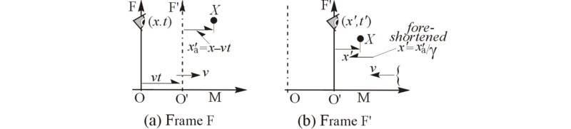

From a previous thread, Nugatory: "If the answers already supplied are not enough for the original poster to work out for themself why x=vt+x'/γ, and not x=vt+γx′, is the correct expression, we can have another thread devoted to only that question."
Here it is. Either Wiki is wrong or I am. In which case I need to know where my reasoning is faulty and why. My derivation:
– the frame A distance xa' of event X from the frame B origin is xa'=x-vt, Fig.(a)
– in frame B, everything stationary in frame A, including the distance xa', moves at speed v, and is therefore foreshortened by γ, Fig.(b)
– whence x' = xa'/γ = (x-vt)/γ, leading to x=vtx' as I maintain
– and not Wiki's x=vt+x/γ'

Your distance ##x'_a## does not transform like that. If you imagine a ruler lying at rest in O where your arrow labelled ##x'_a## is, then in O' it is moving and the ends do not meet event X and the origin of your primed coordinates simultaneously.
You have fallen for the rod-and-barn paradox, in short. The ruler plays the part of the rod, and event X and the origin of O' intersecting the left end of the rod play the parts of the barn doors.
This is horrendously confusing. In Fig. (a) there is no frame A or B.
And I am completely bewildered by the confusing, unexplained, and completely unnecessary ##x’_a##. There should be only x, x’, t, t’, v, and ##\gamma##. Anything else is superfluous.
From the picture it seems like maybe it is just an algebraic shorthand for x-vt, but then it is confusing that an algebraic quantity defined exclusively from quantities in the unprimed frame would be given a primed symbol. So maybe it is supposed to have some other significance, but it is not clear at all.
Assuming frame B is frame F’ and further assuming ##x’_a=x-vt ## then clearly ##x’_a## is not stationary in A (F). The vt term clearly makes one side move at speed v.
Anyway, with all of this confusion it is not particularly surprising that you made a mistake. Notational clarity is important for something like this.

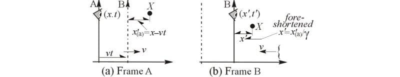

Sorry, there was a duplication of nomenclature. Frame A = frame F = unprimed. Frame B = frame F' = primed. The 'O's and 'M' were from the Wiki article. . I have cleaned up the diagram:
x(a)' is the length x-vt in frame A. x' is the same length in frame B, where it moves at speed v and is therefore foreshortened by γ, giving x'=(v-t)γ. This, however, according to Wiki is incorrect. The question is not whether some other approach gives the 'correct' answer. But rather: why my reasoning, which as far as I can see conforms strictly to SR principles and is completely valid, should lead to a non-standard result.

jeremyfiennes said:
The question is...: why my reasoning, which as far as I can see conforms strictly to SR principles and is completely valid, should lead to a non-standard result.
Because your reasoning contains an error that has been pointed out to you a half-dozen times already by multiple posters, most recently in post #4 above. You have not responded to (or even shown any sign that you have bothered to read) these posts. This is wasting everyone's time including yours, and the thread will be closed if you don't show at least some sign that you are listening.

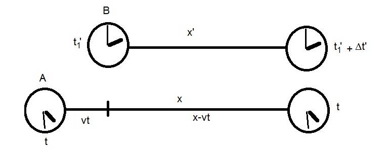

I already tried to explain this, but let me try again. To make it concrete, let's suppose that observer A has a stick of constant length ##x## (as measured in his own frame) that he holds out straight in front of him. At the end of the stick, there is a clock, which is synchronized according to A's frame. Then let's consider the event where that clock shows time ##t##. In A's coordinate system, the coordinates are ##(x,t)##.
Now, let's switch to frame ##B##. In his coordinate system, the location of the clock at the end of the stick is only a distance of ##x/\gamma## away from observer ##A##. So the location of the clock is equal to the location of A + ##x/\gamma##. What is the location of A? In B's coordinate system, A starts off at ##x'=0## when ##t'=0## and is traveling in the negative-x direction at speed ##v##. So at a time ##t' > 0##, A is at location##- v t'##. The clock is a distance ##x/\gamma## ahead, so it is at location##-vt' + x/\gamma##.
Therefore, the point with coordinates ##(x,t)## in frame A corresponds to the point ##(x', t')## in frame B where ##x' = -vt' + x/\gamma##.
##x'## is NOT the length of the stick, it's the location of the clock on the end of the stick. The length of the stick is ##x/\gamma##, and the location is ##-vt' + x/\gamma##.
So the relation between ##x'## and ##x## is ##x' = -vt' + x/\gamma##, which can be rearranged to give: ##x = \gamma (x' + vt')##.
A similar argument shows that the relationship between ##x'## and ##x## can also be written as: ##x = x'/ \gamma + vt##, which can be rearranged to: ##x' = \gamma(x - vt)##
So the two equations are:
  1. ##x' = \gamma (x - vt)##
  2. ##x = \gamma(x' + vt')##
You can rewrite 2. using 1. to get:
##t' = (x/\gamma - x')/v = (x/\gamma - \gamma x + \gamma vt)/v = \gamma (x(1/\gamma^2 - 1)/v + t) = \gamma (-vx/c^2 + t)##
Here is your logical mistake then. Because ##x-vt## is changing and because of the relativity of simultaneity these two quantities are not the same.

jeremyfiennes said:
Thanks. Due to time dilation t'=t/γ, so your x=γ(x'+vt') is equivalent to my x=γx'+vt. On this we agree. But what "similar argument"?
If A has a stick of length ##x##, and there's a clock on the end showing time ##t##, then the location of the clock as computed by ##B## is given by:
##x' = x/\gamma - v t'##
If B has a stick of length ##x'##, and there's a clock on the end showing time ##t'##, then the location of the clock as computed by ##A## is given by:
##x = x'/\gamma + v t##
Those two equations imply the Lorentz transformations:
##x' = \gamma (x-vt)##
##t' = \gamma (t - \frac{vx}{c^2})##

I'm not sure where you got my "x' is the same length in frame B" from.
From here (it is word for word a direct quote):
jeremyfiennes said:
x(a)' is the length x-vt in frame A. x' is the same length in frame B.
I am not objecting to x’, but your quantity ##x’_a## needs to be removed. It is completely superfluous and your use of it is contributing to your mistake.
jeremyfiennes said:
I was probably saying that the length x-vt in frame A corresponds to x' in frame B. Applying length contraction gives x'=(x-vt)/γ.
Here the error is clear. You cannot apply length contraction to x-vt; there is no frame where both ends are at rest.

  1. The distance between B and the clock is ##x'/\gamma##, not ##x'##.
  2. The clock is moving away from the light signal, so instead of taking time ##x'/(\gamma c)## to arrive, it takes time ##x'/(\gamma (c-v))##.
So the light signal takes time ##x'/(\gamma c)## to arrive at the clock, and in the meantime, B's clock advances less than that, by a factor of ##\gamma## (because it's running slow). So when the light signal arrives, B's clock shows time ##t' = (x'/(\gamma (c-v)))/\gamma = \frac{x'}{c-v} \frac{1}{\gamma^2}##
The clock is then set to ##x'/c##, so this clock is set to a DIFFERENT time than B's clock, by an amound ##\Delta t' = x' (\frac{1}{c} - \frac{1}{c-v} \frac{1}{\gamma^2})##. Using ##\frac{1}{\gamma^2} = 1 - \frac{v^2}{c^2}##, we have: ##\Delta t' = - \frac{v x'}{c^2}##
So the relationship between ##t## and ##t'## is not ##t' = t/\gamma##, but ##t' = t/\gamma - \frac{vx'}{c^2}##
From A's point of view, there are two things "wrong" with B's clocks: (1) they are running slow, and (2) they are not synchronized correctly. You need both of these in order to have consistent transformation equations that respect the principle of relativity.
If we plug in: ##x' = \gamma (x - vt)##, then we get the Lorentz expression:
##t' = t/\gamma - \gamma \frac{v (x - vt)}{c^2} = \gamma (t (\frac{1}{\gamma^2} + \frac{v^2}{c^2}) - \frac{vx}{c^2} = \gamma (t - \frac{vx}{c^2})##
