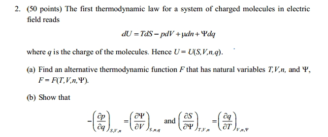

The problem is in the attached .PNG file.
none
I believe I am supposed to do a Legendre transform but have no idea where to begin...
Haven't you seen how to go, for instance, from the internal energy U to the Gibbs free energy G?
