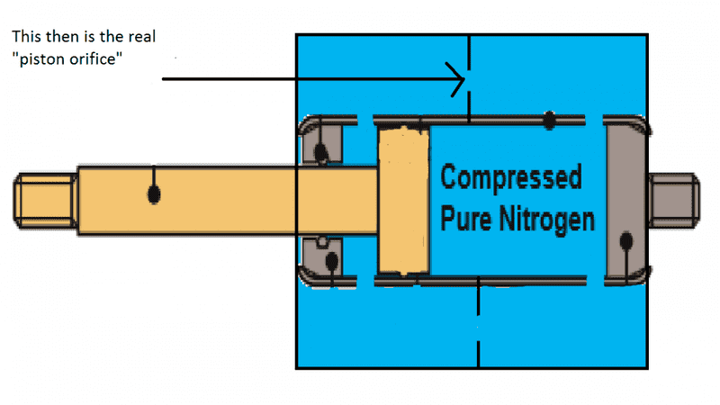

My Idea:
If you could close the piston orifice in the upper picture, the gas spring would stop having a roughly constant force to extension profile and would behave like a normal mechanical spring(following an approximately linear curve with its equillibrium position on the locking position)
The gas springs could additionally apply forces much higher than in their "free" states.
That behaviour is necessary in chairs.You want the chair to be able to hold you up in its locked position but move down with you when you try to adjust the height.

The spring hardness would be higher if you "locked" the spring in one of the more extreme (very short or long) positions due to the smaller volumes that get encompassed on one of the sides.

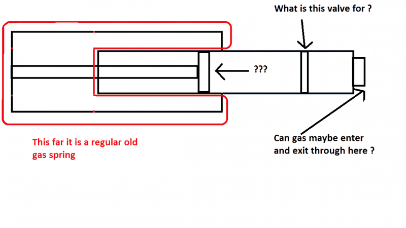

I also thought about and "external gas channel".It could work like this. Then the "spring hardness" would be smaller because of the larger volumes and would vary less with the "extension of locking".

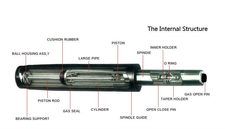

I found this picture on the internet. Maybe you can figure it out ?

Wow, I really appreciate that you found that diagram.:smile:
I at least got the basic principle right, but their design is somewhat more elegant.
I really like how the "venting" is done.It makes me appreciate my chair every time I hear the sound it makes when adjusting the height. :)
But it looks like this design would have the problem I came up with:
The spring stiffness would not be the same for all locking positions.
I tried bouncing on the chair a few times at different heights and that behavior seems to actually happen.
