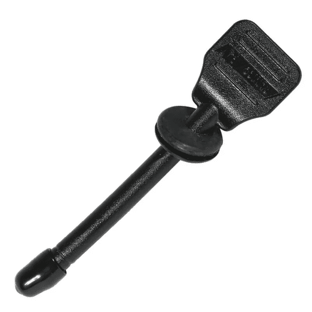

View attachment 298325screen door opener, slide the disc to lock in position.
