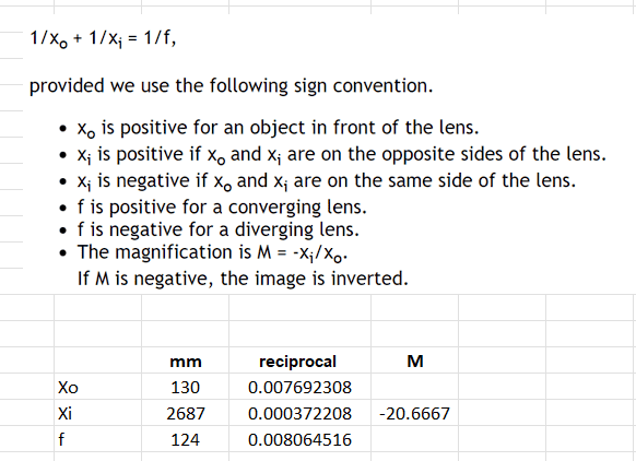

I appreciate the help and it seems I was making this way too complicated. I was trying to apply my experience as an amateur photographer to this. This projector looks like a classic example of the thin lens equation in the links provided by DaveE. I didn't mention the fact that this projector did come with a 124mm lens to focus the light. So the light train is composed of a the lamp, then the collimating lens, then the actual 35mm slide and finally the 124mm single element lens some distance away from the slide. Playing with the math it makes sense and explains why you must invert the slide too!
But I am not trying to form an actual image from one side of the lens to the other so none of this really applies. Like Drakkith says I just need to position my monochromator 124mm from the lens and that is the best I can do. I think I was confusing 'focusing' an object with a lens onto a plane with just 'focusing' or 'converging' the light down to the smallest area possible. If that makes sense?

Those are the same things. The light from an object will form a sharp image when the image plane coincides with the focal plane of the lens.

Both of these statements confuse me. Although I'm sure we all understand the lens equation.

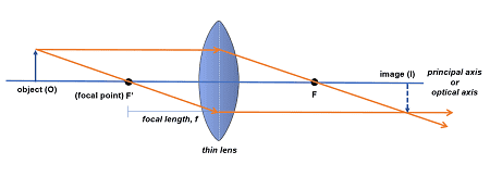

If your object is a point source, then it's image will also be a point. If it has some size, like the length of a lamp filament, then the image size depends on the magnification.
If your incident light is collimated, that is the same as a source infinitely far away, and the image plane will be the focal plane. Otherwise, the image plane is not the focal plane.
Indeed. I guess I should have clarified that I was just referring to the OP's setup with collimated light. The focal point/plane of the lens is not generally located at the image plane. Only when the incoming light is collimated will that occur.
