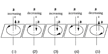

A loop rests in the xy plane. The z axis is normal to the plane and positive upward. The direction of the changing flux is indicated by the arrow on the z axis. The diagram that correctly shows the direction of the resultant induced current in the loop is
a. (1)
b. (2)
c. (3)
d. (4)
e. (5)
emf = - [d(magnetic flux)]/dt
In Figure 4, the magnetic flux is increasing in the -z-direction. From Lenz's Law, there is an opposition to this change, so the induced current will be counter-clockwise, which corresponds to the +z-direction?
Thanks.
Exactly right.
