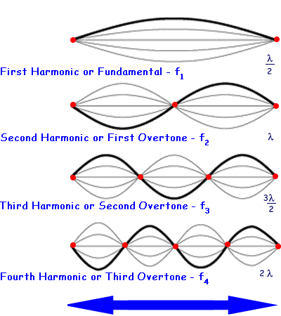

Adjust the mass density or tension so that when we add energy to this section of string we produce the first harmonic.
Is the first harmonic the fundamental, f, or twice the fundamental, 2f = second harmonic ?
If the above is correct (found by Google image search "standing wave first harmonic") I was picturing letting the first harmonic go, though you might ask what if we let higher order harmonics go, I think we get the same result, a standing wave of length L goes to traveling wave of length 2L?
Thanks.

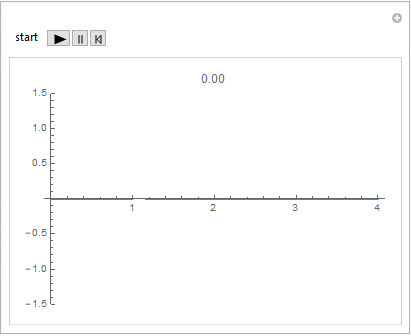

I was losing sleep trying to visualize the shape of the string after the release of one of the nodes o0).
So, I tried making some animations based on some equations in an old book from my college days. I thought I'd share them. I certainly could have made some errors. Let me know if something doesn't look right. They look reasonable to me.
The first animation is for the case where the string is initially oscillating as a standing wave in the first harmonic between x = 0 and x = 1. In the animation, the string makes one complete oscillation as a standing wave before the right node is released. Time is indicated at the top of the graph. (The control tabs are not available in these animations.) I chose the wave speed to be 1 m/s. The period of oscillation of the first harmonic is then 2 sec. So, the right node is released at t = 2 sec.
In the next animation, the string is initially oscillating in the second harmonic between x = 0 and x = 1. The period of oscillation of the initial standing wave is now 1 sec. The node at x = 1 is released at t = 1.
[Edit: This animation has been updated to correct a scaling error.]
Finally, animation for the third harmonic. The period of oscillation of the standing wave is now 2/3 s or about 0.7 sec. So, the right node is released at about t = 0.7.
In all cases, the final total width of the traveling wave is 2 meters. This agrees with @Baluncore's prediction in post #4. :woot:

I did not expect the wave shape to be "rectified", all the "bumps" on one side, minus one for my intuition.
I think there must be a slight glitch in the program, maybe some physics left out. The total energy of the wave must be conserved so in the third animation there is a sudden change in the amplitude which would violate energy conservation. When the pinch point is released that information travels at most wave velocity? The motion of the string on the left can not change until a finite time after the pinch release?
Much to think about, thank you for the animations.

Thank you @Spinnor. I found the scaling errors for the second and third harmonic animations and updated the animations. I think the energy is now conserved. I'm still getting the rectification of the bumps. I was a little surprised at that also, but I don't yet see any mistake in the coding. I'm getting the bumps in the traveling waves to have the shape of sine squared functions rather than sine functions.
