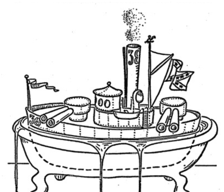

But then we must seal the rim of the bathtub to the ship? Otherwise, why wouldn't it just displace the water out of the tub?
There's an illustration in the book where this is clearly not the case:
No we do not. Floating is floating.
Apropos the diagram: that is a very odd warship. It seems to fly the Confederate battle flag, has two gun turrets each armed with two cannons. The central bridge also sprouting a turret does not fit the profile of a CSS ironclad designed before 1866, the war ending in 1865. The central housing interferes with port and starboard cannon turret rotation even more than actual dual turret monitors. The tall smokestack would be riddled in a first exchange.
The ship diagram looks like a doodle John Ericsson might have drawn after returning to Sweden but why the CSS flag, ship #38, and what is written on the port signal flag? Conclusion: a cartoon.
