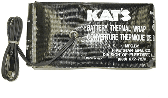

A Kat's 22200 electro-thermal battery wrap is rated at 80W. When you're away from a power source, if you use a 100AH secondary battery that's in a heated part of the camper, then you can run the heat wrap overnight from an inverter that's connected to that battery, and so keep the starter battery warm.

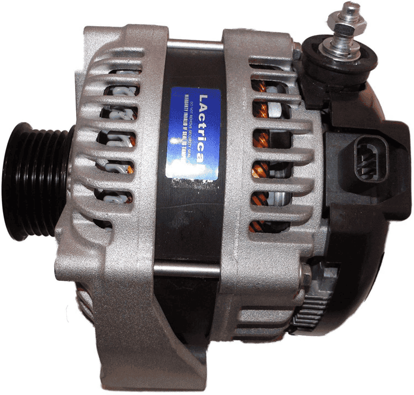

I like the idea of a solar panel array on the rooftop, but it's in my view a good supplement for, not a good substitute for, a 6-phase 300A alternator.

Running the heat wrap for 8 hours after dark with no running of the engine would deplete 80W * 8h = 640Wh of the 1200Wh of a 12V 100Ah battery, which could be replenished in about an hour by a 1kW solar panel array connected to a 75A charger with the heat wrap continuing to draw 80W ##-## reckoning on 5 hours per day of good sunlight, with enough batteries, you could store about 4 kWh per day, depending on what other electrical loads you were running. On gloomier days, some time with the engine idling would top off your batteries, and of course you wouldn't need to run the heat wrap with the engine running.
