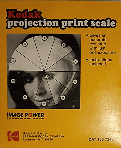

I agree, you'll have to experiment with the actual stuff. My darkroom experience (ages ago) was that you need to know the concepts, but the actual parameters were always found by trial and error.
BTW, one of my favorite cheap tools was a pie chart of ND transmission filters for the first test. Easy and quick.
Interesting! I see B&H has one of these and it's 4x5 in. so I could place it inside my camera, directly over the photo paper. My question is, can I calculate time based on different scales? For example, if I used this and did a minute long exposure, and I found the most properly exposed image at scale 12, would I then be able to use this to determine the best (shorter) exposure time? (I just watched a video of someone using one of these in an enlarger, so it seems I may be able to adapt it to my needs.)
