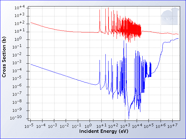

I can be wrong, but I think that the reason that you cannot make a critical mass (Astronuc referred to this) with pure U-238 is the following. The total cross section is higher by a factor of about 5 above the fission cross section in the 1MeV region (where it is in fact the closest). This factor is bigger than the average number of neutrons produced in a fission reaction. As such, with the number of neutrons produced in a fission, you will never produce 1 new fission or more.
In the attachment, the blue curve is the fission cross section while the red one is the total cross section (data from the sigma application on http://www.nndc.bnl.gov/ ).

Every material with a fission cross section can undergo fission (of course) ; the point is that to get any hope of having a net generation of energy, you need a serious amplification of the neutron flux (that is, the neutron flux in the core needs to be a serious factor (say, 20) higher than the incoming neutron flux from the accelerator/spallation. In a normal nuclear reactor, this "amplification factor" is infinite (it is a self-sustained chain reaction), while in a sub-critical reactor, this amplification factor is finite. In a critical reactor, the "k-factor" is 1, while in a subcritical reactor, this is slightly less than one (say, 0.95 for an amplification of 20). But you still need a k-factor very close to 1. And *that* is something that can only be achieved with certain materials.
Now, the k-factor is obtained by considering how many fissions are obtained by the neutrons released by one single fission (you understand that if, for each fission, we cause another fission (k=1), then the reaction is self-sustaining). In the calculation of k, one finds of course:
- the average number of neutrons produced by a fission (A)
- how many of them get lost by other processes, like capture, before causing fission (B)
- how many of them get lost by "geometry" (C).
A is a property of the fission process (and is slightly dependent on the spectrum of the neutrons) ; B is given by the RATIOS of the cross sections and the mixture of different elements. C is given by the size and the density of the material.
Now, if you consider an INFINITE amount of material, then nothing gets geometrically lost, and we have k-infinite. For a specific setup, we have k = k-infinite x g where g is a geometry factor between 0 and 1. If one compresses a material, then one brings g closer to 1. It is the trick one uses in an implosion atomic bomb: k-infinite is of the order of 2, and the g of the non-compressed material is less than 0.5, while the g of the compressed material is close to 0.8, so the k-factor goes from less than 1 (subcritical) to more than 1.6 or bigger (fast divergence).
But if k-infinite is less than 1, no compression can ever achieve criticality.
So for a material like Thorium then, couldn't a similar increase in neutron flux be achieved by increasing the density of the material through compression?
Nope, because for thorium, the k-infinite is less than 1.
