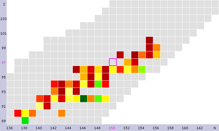

The coloured actinide isotopes (Z=89 bottom) in the attached picture are more or less fissionable, and those of red, reddish brown or brown may be considered fissle.
Image from http://www.nndc.bnl.gov/chart/reColor.jsp?newColor=sigf (zoom 3, or finer to see nuclides, and centering with http://www.nndc.bnl.gov/chart/reCenter.jsp?z=97&n=150). That page arrives from selecting σ(n,F) after selecting http://www.nndc.bnl.gov/chart/
Some of the coloured or grey cells next to the fissile isotopes, where neutron absorption and subsequent beta decay(s) produces a fissile isotope would be considered fertile, otherwise they are not fissile or fissionable.
