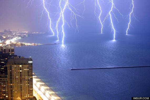

Never seen an explosion yet in either sea or lake strikes. In fact it's a relatively quiet affair.
The neatest thing that can be seen is when there are the streamers coming up out of the water that didnt connect with the downcoming leader
