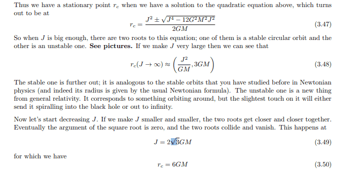

To take the ##lim J \to \infty ##, what are the two roots of ##r_c## in this case...
So I believe it says' ##J## big enough it had 2 solutions' is basically saying just avoiding the imaginary solutions i.e. ## J^4 \geq 12G^2M^2J^2 ## (equality for one route obvs).
see attachment
If I write it as
##r_c= \frac{J^2 \pm \sqrt{J^4}\sqrt{1-\frac{12G^2M^2}{J^2}}}{2GM}##
then as ##J \to \infty ## the last term vanishes and for the + root clearly get ## \frac{J^2}{GM} ## , the first given in 3.48.
However for the - root I would get ##0##. I have no idea how to get ##3GM## , do I need to do some sort of expansion?
Many thanks

Yes, you need to expand the square-root, using ##\sqrt{1-\epsilon} \approx 1 - \frac{\epsilon}{2} + ...##
