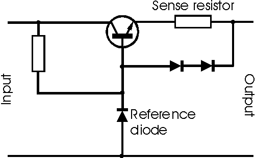

Is there any way to take 12 volts dc from a car battery and have it go thru some components so that what comes out amounts to still 12 volts dc, but is limited to only 20 ma output?

Here is one circuit that works
You have to calculate a value for the sense resistor that will make it drop 0.6 volts at the required current.
In this case, it will be about 30 ohms.
Using Ohm's Law,
Resistance = Voltage / current = 0.6 volts / 0.02 amps = 30 ohms.
But, as Physguy mentioned, you can't have it both ways. If you supply 12 volts to a 100 ohm resistive load, it will draw 120 mA.
Using Ohm's Law,
current = voltage / resistance
current =12 volts / 100 ohms = 0.12 amps = 120 mA
To make it draw only 20 mA you must reduce the voltage to 2 volts.
Using Ohm's Law,
current = 2 volts / 100 ohms = 0.02 amps = 20 mA
Ideally, what you need is a circuit that will give you a steady 12 volts out except if the load resistance is low enough that it will draw more than 20 mA. In this case, the output voltage must reduce enough that the load cannot draw more than 20 mA

Looks like this would work would be nice if it came with resistor values diode type and transistor specifications as some of us folks are not that bright figuring this out ourselves.

That circuit will only give you about 10V output, though. You mentioned you still want 12V at the output, right? What are the specifications for the output? What tolerance can you tolerate in the output voltage.
If you want a true 12V at the output along with the 20mA current limiting, you will probably need to use a DC-DC converter, in a boost-buck or SEPIC topology. Also, 20mA is a pretty low current limit value -- what is the application?

Well, I suppose you could just put a 25 Ohm resistor in series wiith the feed to your device. That will drop 0.5V at 20mA, to give you 11.5V at 20mA for your device. If your device tries to draw more, that will drop the voltage below 11V and your device will go into low-current mode.
0.5V = 20mA * 25 Ohms
Will that do what you want?

VK6 gave the basic approach in his post above - measure the current and control it with some active device. Often one sees a PNP transistor instead of NPN in his circuit; that allows lower voltage drop and is used in "Low Drop Out Voltage Regulators" - a search on that term will be instructive..
