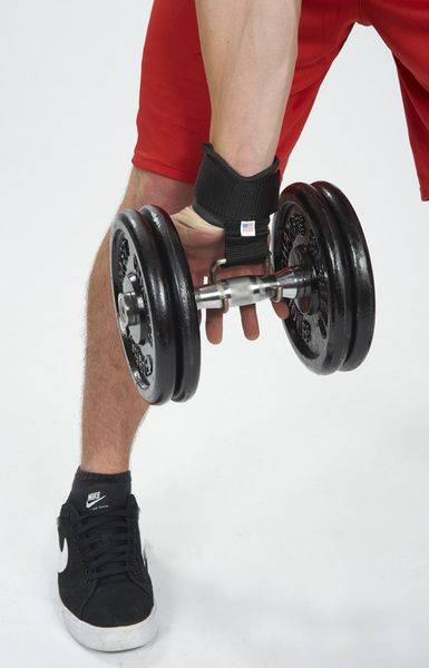

Why don't you put the dumbbell above the center of the metal construction?
Ouch! That even looks painful. I take it the idea is to transfer the weight from your wrist to your forearm. That’s a good idea but as you say, with that apparatus the weight is transferred to one (painful) point.
Have you considered using these Hauling Hooks? They work pretty well for reducing strain on your grip and if attached high enough on your forearm, should take some strain off your wrist.

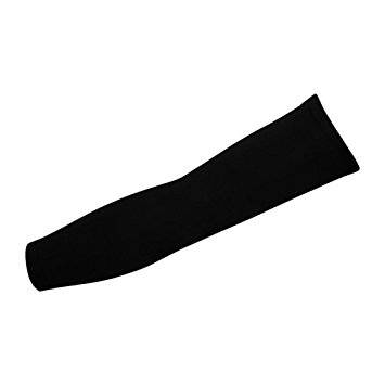

You may want to use them together with an arm sleeve as well.
