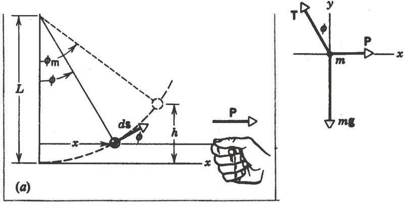

Hi. I have a concrete doubt with this problem. Here's the pic.
Diagram (a) of a pendulum of length L swung by a horizontal force P applied at the hand, showing angles phi and phi_m, horizontal displacement x and height h; right inset shows a free-body diagram with tension T, applied force P, and weight mg acting on mass m.
It asks me to calculate the work done by force P (the ball moves with constant speed). So the solution is in the book and I understood everything, but the problem comes here,
the force P in axis y is zero so the work of P should be:
[tex]\int\limits_{{x_o}}^{{x_f}} {{P_x}dx}[/tex]
And we know that Px is equal to the tension in axis x so:
[tex]\int\limits_{}^{} {T\sin \theta dx}[/tex]
But we need to convert the variable dx into theta variable. And the books states that as:
[tex]x = L\sin \theta[/tex]
then:
[tex]dx = L\cos \theta d\theta[/tex]
But shouldn't it be:
[tex]dx = L\sin\theta d\theta[/tex]??
Why did it take the derivative of sine and not of x on the other side? Thank you!
  • Diagram (a) of a pendulum of length L swung by a horizontal force P applied at a hand, showing the bob at horizontal distance x, height h, angle phi and maximum angle phi_m. Right: free-body diagram with tension T at angle phi, weight mg and force P.
Given:
##~~~x = L sin(\theta)##
Differentiate w.r.t. θ:
##~~~\frac{dx}{d \theta} = L cos(\theta) ##
Rearrange:
##~~~dx = L cos(\theta) d\theta##
