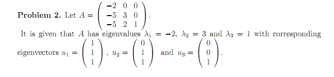

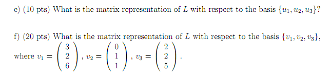

I'm practicing for my finals this coming week and I'm confused about these 2 problems.

For e). I followed my notes and came up with D=U-1AU..since its asking for some basis to standard basis. And once computed, its the diagonal matrix.
D=
[-2 0 0]
[0 3 0]
[0 0 1]
So am I doing it right?
For part F). I don't know if its exactly the same method as above or do I need to get S=U-1V then B=SAS-1
I'm confused with all this!
You've cut off the critical information: what "L" is!
In general, you write a linear transformation, from vector space, V, to itself, as a matrix, in terms of an ordered basis, by applying that linear transformation to each basis vector in turn, writing the result as a linear combination of those basis vectors. The coefficients of each linear combination give a column of the matrix.
