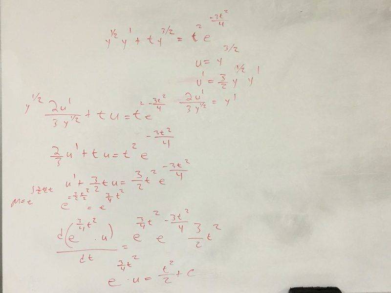

1. Homework Statement
Posted
Posted
Posted
I just need the work to be checked.
I integrated to get the last part.
My only comments are:
1. Your title is misleading; this is not a linear DE
2. Your answer should be an equation with ##y## and ##t##.
3. I won't comment on the steps because of the impossibility of editing images.
Ashley1nOnly said:
View attachment 106286 1. Homework Statement
Posted
Posted
Posted
I almost always avoid looking at posted images, but I can offer useful advice. If you have a differential equation and a (supposed) solution, the standard operating principle you should always apply is to check the solution for yourself, by substituting it into the differential equation and seeing if it "works".
