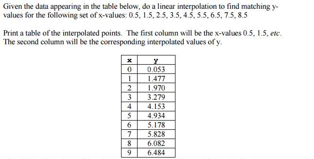

View attachment 5032hi! here's my question. here's my code. i have no idea what to do now :(
Code:
x = 0:9;
y = [0.053 1.477 1.970 3.279 4.153 4.934 5.178 5.828 6.082 6.484]; % data
X = linspace(0,8.5,1);
Y = interp1(x,y,X,'pchip')
I know nothing about MATLAB, but isn't the parameter [m]'pchip'[/m] used for cubic interpolation?
It seems to be after looking at the MATLAB documentation, we want to begin with code like:
Code:
v = [0.053 1.477 1.970 3.279 4.153 4.934 5.178 5.828 6.082 6.484];
xq = 0.5:8.5;
vq = interp1(v,xq);
thank you :) yeah it should have been linear
Do you have any examples where data is displayed in a table format?
no :( that's mainly what I am stuck on
It looks like the [m]array2table()[/m] function could be a place to look. :D
Thank You! There's another problem with my code. Like when I print it I'll only get the last values. Not a table of values
