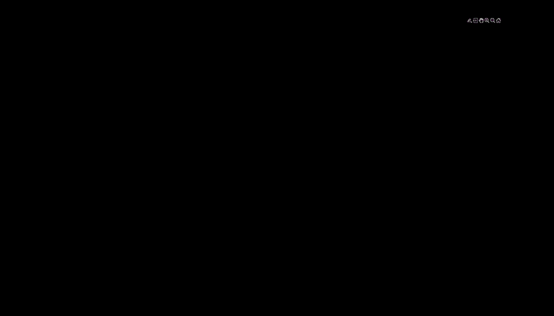

I eventually want to create a vector addition graphic in matlab. As in the literal "head to tail" idea.
Here is my code thus far and it seems to work (I've attached a gif as well so hopefully that works)
Matlab:
va1 = [50*cos(pi/3), 50*sin(pi/3)]; %Two different vectors both starting from the origin
vb1 = [20*cos(pi/6), 20*sin(pi/6)];
iterator = linspace(1,100,100); %100 iterations for the animation inside the for loop
vaiteratorx = linspace(0,50*cos(pi/3),100); % The ending x points for the first vector in successive animations
vaiteratory = linspace(0,50*sin(pi/3),100); % The ending y points for the first vector in successive animations
vbiteratorx = linspace(0,20*cos(pi/6),100); % The ending x points for the second vector in successive animations
vbiteratory = linspace(0,20*sin(pi/6),100);    % The ending y points for the second vector
for i = 1:length(iterator)
    clf
    if i <=50
        initial_point1 = [0,0];
        dp = [2*vaiteratorx(i) 2*vaiteratory(i)];
        q1 = quiver(0,0,2*vaiteratorx(i),2*vaiteratory(i),0,'color','m','linewidth',3,'MaxHeadSize',0.25);
        hold on
    else
        q1 = quiver(0,0,vaiteratorx(end),vaiteratory(end),0,'color','m','linewidth',3,'MaxHeadSize',0.25);
        hold on
        initial_point2 = [0,0];
        dp2 = [2*vbiteratorx(i-50) 2*vbiteratory(i-50)];
        q2 = quiver(0,0,dp2(1),dp2(2),0,'color','c','linewidth',3,'MaxHeadSize',50*0.25/20);
        hold on
            end
    xlim([0 200])
    ylim([0 ceil(9*200/16)]);
    set(gca,'color','k');
    set(gcf,'color','k');
    Ax = gca;
    Ax.XAxis.Visible = 'off';
    Ax.YAxis.Visible = 'off';
    Ax.XGrid = 'off';
    Ax.YGrid = 'off';
    Ax.Color = 'none';
    fig=gcf;
    fig.Units='normalized';
    fig.OuterPosition=[0 0 1 1];
    movieVector(i) = getframe(gcf)
end
myWriter = VideoWriter('SlideTwo','MPEG-4');
myWriter.FrameRate = 1;
open(myWriter)
writeVideo(myWriter,movieVector)
close(myWriter)
What I want to avoid doing is copying and pasting the last part of the last if block for each new else or elseif statement.
If I want to add to eventually add say 30 things to the animation then I will have to copy the last parts 30 times.How do I get around this?
Notice i had to replot "quiver1" for the "else" statement. I would hate to do this endlessly for successive parts.
Anyway I would appreciate any advice about how to approach this and here's the gif.
Wow that gif is slow.

I presume you mean something like this?

I will try it as soon as I get home from thanksgiving dinner! Thank you very much for your response!
It was a simple fix. The overall structure was a bunch of if, elseif, else statements nested in a for loop. The problem was that I wasn't retaining the plots to update as the script goes to the next if statement. This was because the plotting was inside the if statements and therefore limited to that scope.
The fix was updating the variables inside the if block and plotting it outside of the if block (before the end of the for loop) while invoking the command "hold on".
The script is as follows and it produces exactly what I want. @Arjan82 's ideas helped me realize that I needed to think about scope.

Well, you've asked how to do this when you have 30 vectors without all of the copy-pasting. Your solution still does a lot of unnecessary copy pasting and has lots of double code (try doing this for 30 vectors).
But if it works for you it's fine I guess :).
