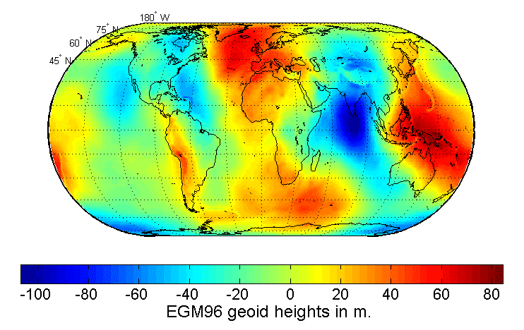

This is from the wiki article, but appears to be the latest version:
Frankly, I was also very surprised at the magnitude of the effect, but if we compare that to the radius of the earth, it is actually pretty small percentagewise. But I also have difficulty understanding how the effect was not noticed soon after the GPS system went online in the late 1980s. Now, until "selective availability" was discontinued in 2000, civilian GPS would not have been accurate enough to notice this, but Navy ships spend a lot of time in the North Sea and I would have expected a GPS expert would have noticed and understood what he was seeing. I will say, though, that as a run-of-the-mill Navy navigator in the early 2000s, I pretty much ignored the altitude data the GPS gave us. That said, "noticing" and actively studying are two different things.
What I'm not clear on though is the deviation between the 1996 and 2004 versions: was it really a factor of 10? And if so, why? This is a military project, so I'm wondering if there was some secrecy involved (related to the shutoff of selective availability).
I would be curious to know if we have any PF users from New Guinea who could stand on a beach and tell us what their GPS says.
Conveniently enough, here's an online calculator that outputs the deviations for EGM2008, 96 and 84 versus WGS84:
http://geographiclib.sourceforge.net/cgi-bin/GeoidEval?input=60 -20&option=Submit
I entered in a bunch of coordinates I though might show the discrepancy and am seeing very little. For example, what I linked above should give you 60N, 20W, and the elevations are 60.66, 60.69 & 60.30 meters, for 2008, 1996 and 1984 respectively.
-5, +143 gives a discrepancy between 1984 and the newer ones, but still not that big: 80.9, 80.5 & 77.6

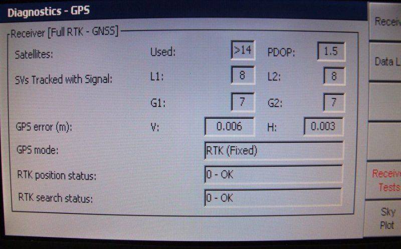

Vertical ionospheric delay cannot be fully compensated for because we have no GPS satellites underground.
The GPS gear I work with on a daily basis has good accuracy
less than 10 mm in vertical or horizontal
I always find that the vertical error is usually at least double the horizontal as seen in the attached screen shot of one of my customers units on test
cheers
Dave
I thought RTK was a differential GPS mode. Unfortunately, differential GPS referenced to a nearby fixed station cannot be used to measure global deviations from the ellipsoid, it is used to eliminate geoid, tidal and ionospheric effects. If the GPS reference station was not local then you would see the difference between the Earth's surface responding to tidal forces and the regional variation in ionospheric propagation delay.

EGM84 is the original geoid model
Original? Not by a long shot!
The concept of a geoid dates back to the early 1800s. George Stokes developed a mechanism for calculating the geoid in 1849: Stokes, G. G., 1849: On the variation of gravity at the surface of the Earth. Trans Cambridge Phil. Soc., 672. It was a bit unwieldy (especially without computers), and it was a bit difficult to generate a global model, but people did work on this. Development ramped up massively with artificial satellite and digital computers. People have been developing satellite-based gravity models (and hence geoids) pretty much since the onset of the satellite era.
