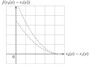

I'm looking for prescription of function [itex]f[/itex] with behavior:
Graph of f(r2(x) - r1(x)) against r2(x) - r1(x) with two dashed decreasing curves that approach zero at the horizontal axis, both starting above the axis at the origin.
putted in this system of DE solving some simple functions [itex]r_{1}(x)[/itex] and [itex]r_{2}(x)[/itex]:
[itex]\frac{d^{2}r_{2}(x)}{dx^{2}}=\frac{f(r_{2}(x)-r_{1}(x))}{C}[/itex]
[itex]\frac{d^{2}r_{1}(x)}{dx^{2}}=-\frac{f(r_{2}(x)-r_{1}(x))}{K}[/itex]
[itex]r_{2}(x)-r_{1}(x)>0;f(r_{2}(x)-r_{1}(x))>0;C,K>0[/itex]
  • Graph with horizontal axis r2(x) - r1(x) and vertical axis f(r2(x) - r1(x)), both starting at 0; two dashed decreasing curves start at positive heights on the vertical axis and approach zero as the horizontal value increases.
3.31143 - 1.37286 x + 0.135714 x^2
fits more or less the lower curve
