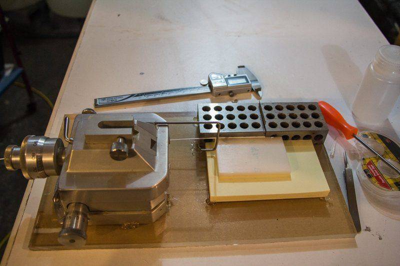

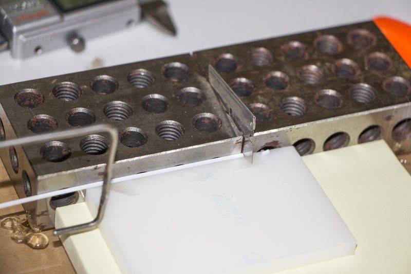

It get the length right and have the cuts somewhat at right angles, I made a little microtome:
I used the micrometer on the microtome stage (which I salvaged) to push (via bent wire) a piece of plastic forward.
The plastic square rod is taped to the plastic with double sided tape.
A razor blade is held between the two metal blocks
Everything is held in place by two sided tape and heat glue.

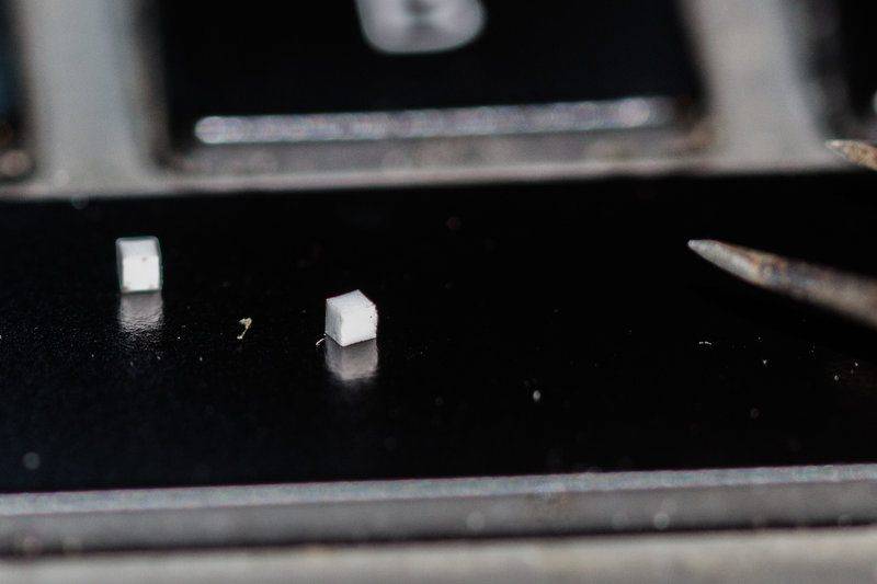

This is one of the resulting cubes.
