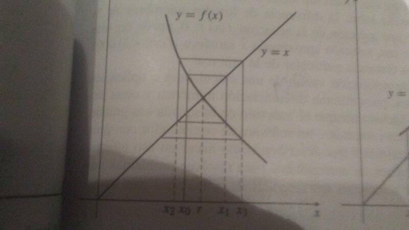

Hi PF
Not every function works when we try to compute the root with this method
Cobweb diagram of fixed-point iteration: curve y = f(x) decreasing and the line y = x crossing at the fixed point r, with stair-step iterates x0, x1, x2, x3 marked on the x-axis converging toward r.
The following theorem guarantees that the method of fixed point iteration will work for a particular class of functions
A fixed point theorem
Suppose that ##f## is defined on an interval ##I=[a,b]## and satisfies the following two conditions
(i) ##f(x)## belongs to ##I## whenever ##x## belongs to ##I##; and
(ii) there exists a constant ##K## with ##0<K<1## such that for every ##u## and ##v## in ##I##
$$|f(u)-f(v)|\leq K|u-v|$$
Then ##f## has a unique fixed point ##r## in ##I##, that is, ##f(r)=r##, and starting with any number ##x_0## in ##I##, the iterates
$$x_1=f(x_0),\qquad{x_2=f(x_1),...}$$
converge to ##r##

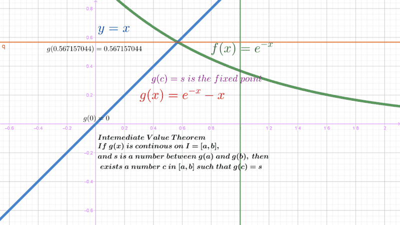

Ok, restart with an easy exercise. Find a root of the equation ##x=e^{-x}##. I play tricks graphing ##g(x)=e^{-x}-x##, just to find out ##x_0=1##. Twenty iterations lead me to ##r=0.567157044##, ##\mbox{error}<10^{-4}##.
Now let's leave behind this weird example to talk about ##f(x)=e^{-x}##. What means ##Im(f)\subseteq{Dom(f)}##? ##[0,1]\subseteq{[0,1]}##?

I think this is what the textbook suggests, for ##x=e^{-x}##. I've done it quickly: up the image, there should appear ##g(1)=-0.632120558##. I think the ##I-VT## is the key to get the fixed point
Graph with y = x (blue line), f(x) = e^(-x) (green curve), and g(x) = e^(-x) - x (red label), with a horizontal line at y = 0.567157044 where g(0.567157044) = 0.567157044 and the curves y = x and f(x) meet; a box states the Intermediate Value Theorem.

Intermediate-Value Theorem applied to ##g(x)=f(x)-x##,
If ##g## is continuous on ##[a,b]## and ##s## is a real number lying between the numbers ##g(a)## and ##g(b)##, then there exists a point ##c## in ##[a,b]## such that ##g(c)=s##.
1- ##g## is continuous on ##[a,b]## because ##f(x)## and ##x## are
2- ##x\in{[a,b]}\Rightarrow{f(x)\in{[a,b]}}##
3- Hypothesis: ##g(a)<s<g(b)## (the same if ##g(b)<s<g(a)##):
4- ##\exists{c}## in ##[a,b]## such that ##g(c)=s=f(c)-c##
5- ##f(a)-a<s<f(b)-b##, on ##[a,b]##
6- ##f(b)-b<s<f(a)-a##, on ##[a,b]##
7-##\therefore{s=0\Rightarrow{\exists{c}}}## such that ##f(c)=c## on ##[a,b]##
Is it ok?
Regards!
You make a hypothesis in step 3, and later steps depend on that hypothesis (or its alternative, in parentheses) being true. So you need to show that that hypothesis or its alternative is true. You have not shown that. In fact you need to show that either:
- the hypothesis is true, or
- its alternative is true, or
- g(a) = 0, or
- g(b) = 0
Also, you should fix s=0 at the hypothesis step, not leave it an unfixed variable.
