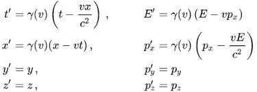

Photons deviate from the above energy-momentum transformations under certain circumstances while still in flat space-time, I'm wondering what set of transformations would more accurately describe them over as wide a range of circumstances as possible, still in flat space-time, I've searched and I'm hoping I can get some useful info.

No they don't.

Hmm, ok, I was looking at the transformation of frequency of a monochromatic point source:
##f'=γ(1-βcosθ)f##
It is equivalent to the energy transformation above. But it is only a far-field approximation.

What makes you think that that is any different from the transformation you gave above?

hmmm? I said it is equivalent mathematically. But it is a far-field approximation, so there should ostensibly be another more accurate transformation.
I think you need to lay out what you think is a far-field approximation to what.

As mentioned above, for a monochromatic point source. The formula gets closer to the value of f' the further away the "photon-event" is from the source.
So far you have given nine formulae. One of them you think is an approximation to something. I have no idea which formula you think is an approximation or why you think this.
You need to explain what you think is an approximation and why you think it is an approximation. Simply saying "the formula is a far field approximation" is leaving me with no idea what it is you are asking about.

Ok, the formula in #3 is equivalent to the energy transformation, which is the top right one of the eight formulae.
The left side are the space-time transformations, but they just came with the image, they aren't part of the discussion.
The formula in #3 is derived from far-field approximation considerations, so it ostensibly necessitates another more accurate transformation.
