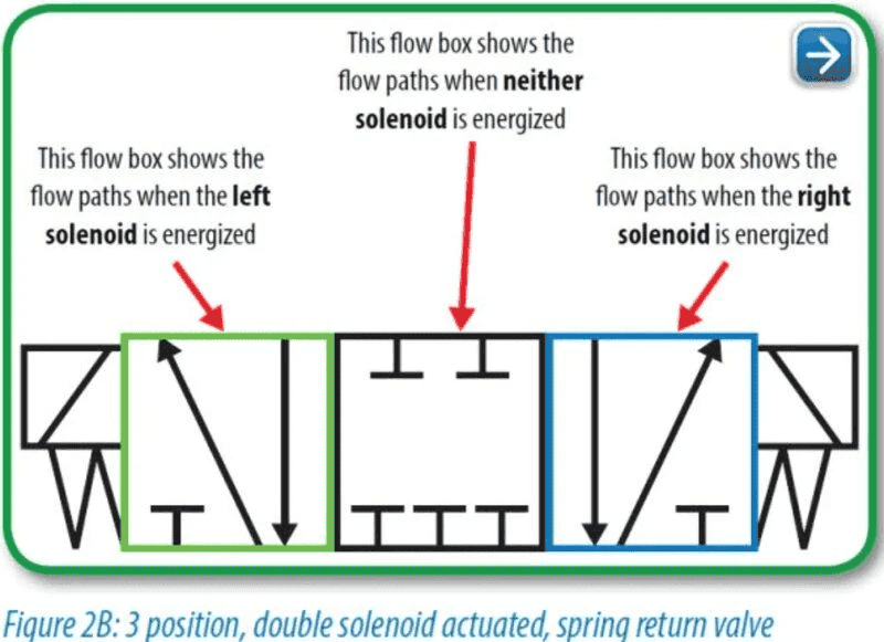

It sounds like you need a three position, double solenoid, spring return valve. This diagram shows the terminology (but has the wrong valve porting):
You need to find a valve that:
1) When Solenoid A is energized, the cylinder is pushed one way,
and
2) When Solenoid B is energized, the cylinder is pushed the other way,
and
3) When neither solenoid is energized, the valve spool is spring loaded to the center position, where the cylinder ports are connected to each other.
Your next step is to get some pneumatic valve catalogs and start searching. This might take a while, but if you are persistent, you should find a valve.

If the central position needs to be floating, then both sides of the cylinder need to be connected to the tank in that position. That is because the rod has a finite volume, so the total volume of the cylinder changes as the piston moves.
It gets more complicated if, when the power is on, you want the cylinder to be held in the last adjusted position. There is then a safety consideration, will a supported load fall whenever there is a power cut.

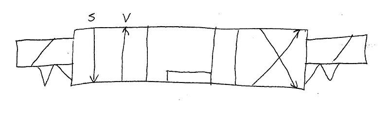

So a pneumatic solenoid valve like this:
Valve is spring loaded to center, S is supply, and V is vent.
Don't worry about the valve port size. You can find fittings to adapt any valve port to any tube, hose, or pipe.
Thanks for all your input, Sorry for my delay in getting back to you ...
Looking at the post form Jrmichler I was thinking alone the same lines.
however: When I tried that valve is would stop the rod anywhere along the full travel BUT when power is removed the rod is held in place and will not run free.
I think the valve would need to more like this:
I am thinking that when the valve has no power and is in the center position either both cylinder ports need to be joined together or both need to be connect to the exhaust.
The question is now, do they make this type of valve or do I need to look at using a second valve vent or maybe just shut the air of the supply.
Your Thoughts ...
In the central position, the two cylinder ports should be connected to the exhaust vent, while the supply is blocked.
