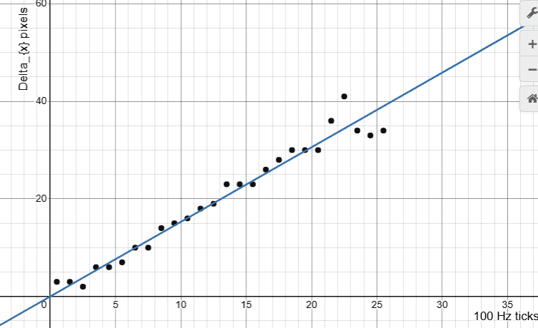

Thanks for the link - very informative. My data (measured from the slow motion free fall video in post #14) has the same problem with first differences being "wobbly" and second differences even more so. Gets worse at higher sampling frequencies: The regression fit below gives g=9.67 m/s/s which is not too bad I suppose Quadratic fit (a * x^2) on the underlying position data gives g=9.85 m/s/s.
I think there's scope to give some careful thought as to how to reduce 'wobble' and generate data sets which are more linear at first difference and more constant at second!
This post is sort of like throwing stuff against the wall to see what sticks.
Hmm... that sounds more like an instrumentation problem, as in the camera or its optics, or maybe vibration from not being solidly mounted... or even in the setup of the tape versus the dropped object.
For instance there are five occurences of "groups of 3" in the graphed data.
Tracking it down could be a major research project in itself though!
Any chance you can beg, borrow, rent, or steal, a high frame rate camera ("slow motion" camera)? And maybe put a metronome or a high resolution fast mechanical timer in the frame. (Even a recently calibrated oscilloscope syncronized to the power line.)

Thanks for the suggestions on possible causes of error in the data set. Apologies if my posts are a bit erratic. I think the main request is exactly what you've asked for - namely a data set from a high frame rate camera video of free fall motion set against an accurate scale and including an equally high rate timer device. Unfortunately I don't have such kit available to me unless I invest lots of time in doing a Arduino or raspberry pi project perhaps.
Have written to Dr Rod at his very excellent Hyperphysics website requesting such. I said for me the "experimental jury" is still out on constant g since I have yet to see convincing evidence of constant second differences in a free fall data set.

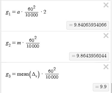

Edit: Graphed the first 14 points of the Hyperphysics dataset. I would say after that the bob hit some kind of "speed wobble" since thereafter the data is inconsistent. Probably this is about as good as it gets for (reasonably) constant second differences. Values of g calculated on regression fits of original data and first differences and mean of second differences are (again reasonably) consistent.
https://www.desmos.com/calculator/u153wz7jkh
Good idea. Could you video the tape as it's pulled through, to see if a wave forms?
Edit: The bob is fairky massive but the tape could have a transverse vibration and catch on the slot it runs through. Of course, the tape method and mechanical marker has always been aimed at potentially clumsy kids. I have always found that it's aimed at moderate experimental skills and they nearly all get results that they 'understand'. Most exercise books tended to have a convincing graph, made with sections of their tapes. Sometimes, a value of g (actually g cos(θ)) on a sloping runway would turn up.
'Improvements' to this basic method would still fall short of methods with no contact on the falling object - nearer to free-fall.
I'm doing a 'virtual experiment' using the Hyperphysics data set so I don't have access to the physical equipment. But if you look carefully at the section of tape photographed (don't know if it's representative of the data set shown ?) , you'll see the dots are not quite in line which indicates a small transverse oscillation the amplitude of which could increase with time.
