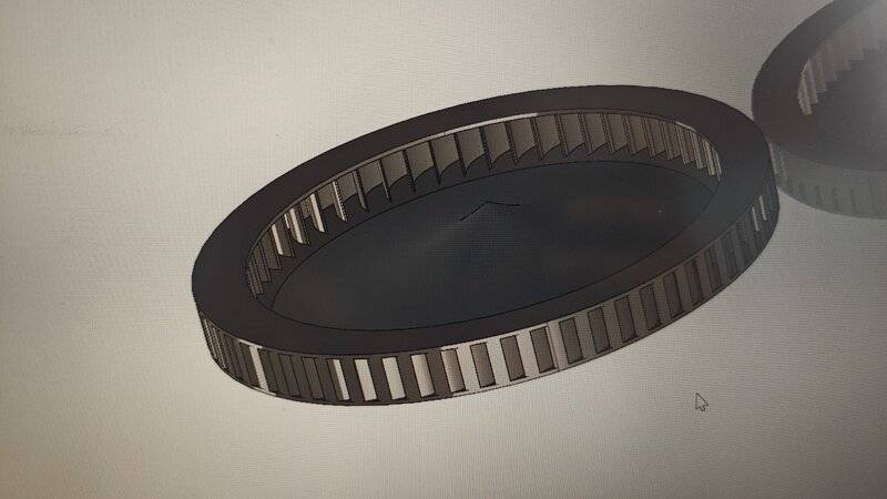

I am looking for suitable ball bearings for my waters turbine because I have found that without the bearing the turbine rotates well but when a shaft is attached and bearings are fitted, the RPM reduces drastically.
I made a waters turbine CAD design and make prototype with a 3D printer. I first tested the turbine by putting it at the tip of a ball point pen. At the tip of the ball point pen, the turbine rotates well. I made a video but there is no option by which I can upload the video. Later I attached a shaft and bearing but found that the RPM reduced drastically in the same condition when when the shaft and bearing is attached. Can't understand the reason.

This is the turbine. Everything will be clear if I will be able to upload the videos, but there is no way I was able to upload those. It's basically a Waters turbine.

We do NOT need videos, we need dimensional data and a diagram of the mounting shaft(s).
What is the outer diameter of the turbine?
The diameter of the turbine is 25 cm and the shaft diameter is 15 mm. Kindly note that when the turbine is put at the tip of a ball point pen and set before a ceiling fan, it rotates well. But the RPM drastically reduced when the shaft and bearings are attached.

Ball bearings are available as open, shielded, or sealed. The open and shielded have the lowest friction, while sealed have the highest friction. Part numbers for a typical ball bearing for a 15 mm shaft are:
Open: 6302
Shielded: 6002-2Z
Sealed: 6002-2RS

Will it be used in water or in air?
In air.

The power available from such a small wind turbine is insufficient to justify a ball bearing.

That you spin it on the tip of a ballpoint pen, or on a thin steel wire shaft, less than 1 mm in diameter.

Any attempt to take energy from the airflow, will block the airflow through the turbine, the air will go around the outside, so the turbine will stall.
The cost of buying and installing a ball bearing will exceed the total power generated over the life of the system.

The shaft diameter is too big, so balls travel too fast and too far.
You need to reduce the shaft down to a couple of millimetres at most.
https://www.ebay.com.au/itm/135243236381?
If they have thick oil, wash the oil out of the bearings with diesel or a lighter oil.
