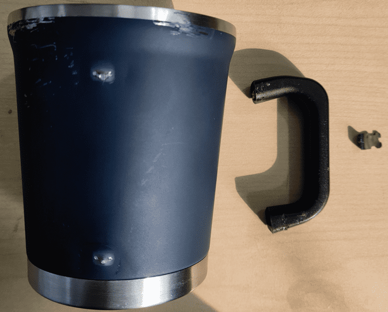

How to join a plastic part with a metal part?
i have a plastic handle and want to join it with a metal body. i can join it with heat stacking method i have find a product who done done that.
is there any other way to join permenently?
I have usually seen either weld-nuts on the metal part with machine screws going thru and holding the handle, or making the plastic part slightly deformable with 'hooks' or 'latches' that fit in cutouts in the metal.
There are also instances of having sheet metal barbs that insert into the plastic. Depending on the ultimate use, the barb may be either molded into the plastic of merely inserted into a preformed slot in the plastic.
For do-it-yourself, I have not been able to to get a reliable connection by thermoplastic welding the plastic onto the metal.

Are we talking about that mug (?) on the picture?
Based on the picture there should be some metal pieces in the handle and originally it was a metal-metal connection, maybe done with spot welding.
I don't think this can be repaired easily (and, what's more omportant: it won't be any sturdier than before).
What I would do ... well, honestly, I would just buy a clay mug, but to use that one on the picture I see two ways:
- to make two rings of metal strap attached to the old handle and make the mug sit in the rings
- make a complete new handle&rings entirely from some steel wire
Something like these, but more 'engineer way':

I don't think this can be repaired easily (and, what's more important: it won't be any sturdier than before).
Very true.
Do not waste time reattaching an old plastic handle to a metal container.
Plastic becomes brittle with time, it then fails at a progressively lower stress.
Replace the handle with new, or with an improved material.
sorry guys, i think i have not given proper question.
it is just a example to understand what i want. what i really want is a way to join a plastic part with a metal part (a hybrid assembly - i think).
Thank you for your concerns.

this picture is given as an example explain to what i really want.
'I just want a any other method to join a plastic part with a metal part.'
i got two way to join
1. Heat Stacking
2. fasteners
is there any other way?

Are you looking for something what can be industrialized (like that handle from the picture), or just DIY level will do?
For the letter, as I recall there are some glues which can bond on plastic and metal too. But I would keep those only for places without much stress of any kind.
Synthetic resins (even with some fibers added) may be also do the trick (not just used like a glue but as means of extra mechanical support).

for industrialized level
Yeah, go with a mechanical fastener. Personally, I'd say threaded rod welded to the body, and nuts to hold the handle on.
I just did a post on bonding metals with epoxy. Search "Methyl Methacrylate adhesives" There are formulas that are mix compatible with metals and plastic. And their bond is outstanding.
