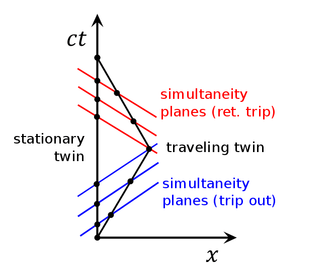

OK, what if after a travels from A to C, instead of continuing in the same direction when he meets b coming the other way, he turns around (instantly) and follows along with b from C to A. Will both a and b continue to have the same times on their two clocks?
  • #115
Well, again we have a difference between the accepted wisdom and teachings of the Minkowski diagram showing the dogleg portrayal of the traveling twin's journey.
If one takes that diagram:
There are 4 problems that leap out at one:
1. It is not drawn to a consistent scale;
2. The second part of the traveling twin's journey is not rotated about the origin;
3. The plane of simultaneity must surely also encompass all points on the stationary twin's FoR that are simultaneous; that is parallel to its x axis. We are, after all, viewing the stationary twin's FoR.
4. If the relative velocity is depicted by a clockwise rotation of the traveller's ct' axis, then how can it also be shown by the corresponding anti-clockwise rotation of the x' axis? Surely the ct', x' frame can only rotate one way?
Resolving these issues by drawing diagrams that reflect reality and answer all these points shows that indeed a anb will continue to have the same times on their clocks!
  • #116
There is no scale indicated, but the drawing is essentially correct for one specific kind of non-inertial reference frame.
There is no requirement that it be rotated about the origin.
No, this is the whole meaning of the relativity of simultaneity. The planes of simultaneity will NOT be parallel in general. If they were always parallel then simultaneity would be absolute, not relative.
If they rotated as you describe then the speed of light would not be invariant. The rotation is not an ordinary circular rotation, but a hyperbolic rotation. It looks more like a shear along the x=ct line. What is drawn is correct.
You should verify this yourself simply by drawing the lines of constant time and position indicated by the Lorentz transform. I strongly recommend that you go through this exercise. For convenience use c=1 and v=0.6. Simply take the Lorentz transform equation for x' and set x' to 0, this will give you the equation of a line in x and t, plot that line. Then set x' to 1. This will give you the equation of a different line in x and t, plot that line. And so forth for x' = 2 and then t' = 0, 1, 2. That will show you what the Lorentz transform looks like.
No, you need to learn a little more, the diagram is essentially correct.
