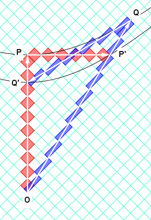

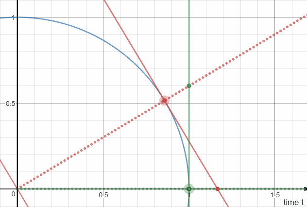

robphy said:
A spacetime diagram is essentially a position-vs-time diagram (as opposed to a spatial diagram of moving boxcars). By convention, the time axis runs upwards instead of to the right, as in PHY 101. The usual stumbling block is how to motivate and determine the ticks along lines that are not parallel to the coordinate axes.
Here's my introduction to spacetime diagrams, motivating a graphical method using light clocks.
https://www.physicsforums.com/insights/spacetime-diagrams-light-clocks/
and more recently
https://www.physicsforums.com/insights/relativity-on-rotated-graph-paper-a-graphical-motivation/
which uses the Doppler effect and what you call "reciprocity" to develop special relativity.
My answer to https://physics.stackexchange.com/questions/383248/how-can-time-dilation-be-symmetric
uses diagrams like this to display the reciprocity
which is analogous to what happens in ordinary Euclidean geometry
(using https://www.desmos.com/calculator/wm9jmrqnw2 with E=-1 ).
The essence of the first diagram is essentially what @Dale is suggesting, with [itex]\gamma=5/4[/itex] (i.e. [itex]v/c =3/5[/itex] and [itex]k=2[/itex]), which is arithmetically nicer than either [itex]v/c =1/2[/itex] or [itex]\gamma=2[/itex].

  • #62
If the Lorentz factor is 2 the two clocks synchronize to an initial reading of zero when they meet then if the rest clock (A) ticks to 10 the other clock (B) will tick to 5.
But at the time the other clock (B) is 5 B will perceive the clock A as ticking to (2.5).
But at the time A is 2.5 A will perceive B as ticking to 1.25
This is one of the issues I run into, the clocks seem to be inconsistent when going back and forth and switching from the perspective of one clock to the perspective of the other.
How can I make the symmetry of time dilation consistent in my mind?
  • #63
By including relativity of simultaneity in your analysis. You keep using the phrase "at the time" repeatedly without taking into account that each time you use it, it's a different time--a different pair of simultaneous events.

  • #68
The spacetime diagrams in my post offer a geometrical way
to encode what it means that "B will perceive A...".
For B to determine "what pairs of events are simultaneous",
B constructs a line that is spacetime-perpendicular* to B's worldline.
( * perpendicular using the Minkowski metric ).
  • In the diagram with the diamonds, follow the spacelike diagonal of one of B's light-clock diamonds.
  • Alternatively, along B's worldline, construct the tangent line to the "circle" (a hyperbola in special relativity) whose center is on B's worldline. The Euclidean version is shown in the second diagram.
    Use the desmos visualization with E=+1 to see the special-relativity version.
If you follow the above construction, you'll see that your sequence refers to a sequence of different pairs of events. (Only in the E=0 Galilean case will the sequence of pairs overlap... and do so without inconsistency... but that's not in agreement with special relativity E=+1.)
