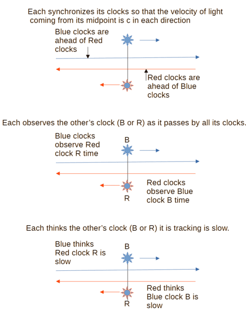

FactChecker said:
When a "stationary" IRF observes a relatively moving clock as it moves forward, it is not using the same "stationary" clock all the time. It is using the synchronized "stationary" clocks down the line of motion of the moving clock. If you switch the IRF that you call "stationary" then the "stationary" clocks that are used are in the opposite direction. So completely different sets of clocks are being used. That is how each will think that the other's clock runs slow.
Does IRF stand for inertial reference frame?

The exercise you gave me was a little unclear because I'm inexperienced with some of the concepts but I am trying to learn. I'll make an effort to work out the thought experiment again a little later.
Mister T said:
You need more than two clocks moving relative to each other. Let's call them A an B. Say you have a third clock, C, at rest relative to B. They are synchronized in their rest frame and lie along the line of relative motion. When A passes B we note the readings on each clock. Then later, when A passes C we again note the readings on these clocks. By examining the readings we conclude that A is running slow compared to B and C.
But in the rest frame of A the clocks B and C are not synchronized.
Now introduce a fourth clock, D, at rest relative to A and repeat the above procedure as B moves past them. Now we conclude, by the same reasoning, that B is running slow compared to A and D.
Any good textbook will work out the details and show that it's the relativity of simultaneity that accounts for the symmetry of time dilation.
I thought I already asked you to work this out in another thread and instead of responding with an attempt you simply hit the like button.
Go to YouTube and do a search for Paul Hewitt Trip. Watch that old cartoon.
Edit: Paul Hewitt Twin Trip.
Are you saying that in the rest frame of clocks B and C the clocks B and C are synchronized (ticks of B and C happen at the same time) but relative to the rest frame of A (where B and C moving) the clocks B and C are not synchronized and tick at different times?
Sorry if I misunderstood some things, the example is a little difficult for my imagination.
I wish I still knew where my Morin book was, reading it might help me understand the symmetry of time dilation.
