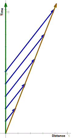

Hi Grimble, there are a few problems with this chart.
1) In spacetime diagrams the time axis is traditionally vertical and the space axis is horizontal. It is ok to switch it around, but then you should label it.
2) For AA (the clock going horizontally from A and staying on A) coordinate time will match proper time.
3) For BB coordinate time will match proper time.
4) For AB proper time will be slower than coordinate time by a factor of 0.8, meaning that on the line where coordinate time is 5 the proper time for AB is 4, not 5.
5) Similarly for BA.
6) You have not shown any lines of simultaneity for AB or BA, only for AA and BB.
