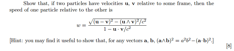

If two particles have velocities u and v in frame S, find their relative speed in frame S'.
Isn't it strange that the relative speed doesn't depend on the velocity of the frame, ##\vec s##?
Since the two particles have velocities ##\vec u## and ##\vec v## in some reference frame S, I am to find the relative velocity and speed in frame S'.
Letting the relative velocity of the frame be ## \vec s##, the transformation of velocities are:
[tex] \vec u' = \frac{1}{1 - \frac{\vec u \cdot \vec s}{c^2}}\left[ \frac{1}{\gamma_s} \vec u - \left( 1 - \frac{\vec u \cdot \vec s }{c^2}\frac{\gamma_s}{1 + \gamma_s} \right) \vec s \right][/tex]
[tex] \vec v' = \frac{1}{1 - \frac{\vec v \cdot \vec s}{c^2}}\left[ \frac{1}{\gamma_s} \vec v - \left( 1 - \frac{\vec v \cdot \vec s }{c^2}\frac{\gamma_s}{1 + \gamma_s} \right) \vec s \right][/tex]
Taking ##\vec u' - \vec v'## only gives me components in ##\vec u, \vec v, \vec s ##. How do I extract the magnitude?
Note: the "speed of particle B relative to particle A" is the speed of particle B as measured in the reference frame moving with particle A.
So, what should you choose for primed frame, S'? Hence, what should be the velocity ##\vec{s}##?
Yes, I misread the question. ##\vec s## is simply ##\vec v##. Then all that remains is to find the magnitude. But it looks very messy due to the ##\gamma_v##
[tex] \vec w = \frac{1}{1 - \frac{\vec u \cdot \vec v}{c^2}}\left[ \frac{1}{\gamma_v} \vec u - \left( 1 - \frac{\vec u \cdot \vec v }{c^2}\frac{\gamma_v}{1 + \gamma_v} \right) \vec v \right][/tex]
To find the magnitude I would take ##\sqrt{ \vec w \cdot \vec w}##

I derived the expression ##
\vec w = \frac{1}{1 - \frac{\vec u \cdot \vec v}{c^2}}\left[ \frac{1}{\gamma_v} \vec u - \left( 1 - \frac{\vec u \cdot \vec v }{c^2}\frac{\gamma_v}{1 + \gamma_v} \right) \vec v \right] ## by using ## u_{||} = \frac{(\vec u \cdot \vec v) \vec v}{|\vec v|^2} ## and ## u_{\perp} = \vec u - \vec u_{||} ##.
I thought it would be easier, because finding the magnitudes of the horizontal and vertical components would involve angles and such.
If you want to work with the components, you can write ## u_{||} =u \cos \theta## and ## u_{\perp} =u \sin \theta##. Then the velocity-addition formulas for the two components will be fairly easy to work out.
So do you reckon it's easier to simply take ##\left[ \frac{u cos \theta - v}{1 - \frac{uv cos\theta}{c^2}} \right]^2 + \left[ \frac{u sin\theta}{\gamma (1- \frac{uv cos \theta}{c^2})} \right]^2 ##?
Yes. Note that in the denominators you have ##1 - \frac{uv cos\theta}{c^2}## which is part of the answer you want.
