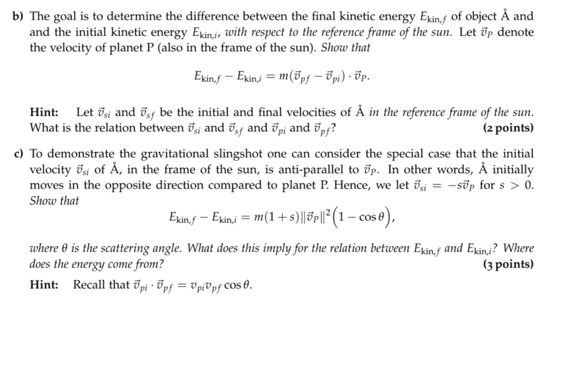

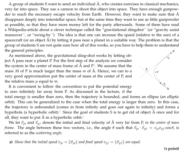

Hi,
the task is as follows
Unfortunately, I am not getting anywhere at all with task c. I have now proceeded as follows:
I assume that the calculation takes place in the reference system of the sun. In the task the following is valid, $$\vec{v}_{si}=-s\vec{v}_p$$ I have now simply assumed that the planet is scattered the velocity vector by the angle $$\theta$$ so the following is valid for the final velocity
$$\vec{v}_{sf}=-s\vec{v}_p*cos(\theta)$$
After that I simply made the difference in the kinetic energy, i.e.$$E_{kin,f}-E_{kin,i}=\frac{1}{2}m\vec{v}_{sf}^2 - \frac{1}{2}m\vec{v}_{si}^2$$If I now insert $$\vec{v}_{sf}=-s\vec{v}_p*cos(\theta)$$ and $$\vec{v}_{si}=-s\vec{v}_p$$, I immediately see that I do not get the required equation, since I have terms like $$s^2$$ and $$cos(\theta)^2$$. But I also don't understand how to get this equation where $$s$$ and $$cos(\theta)$$ occur, you have to square the velocity for the kinetic energy.
Part (b) is setting you up for part (c). Thus, you can express the change in KE of ##\mathrm{\mathring{A}}## relative to the sun in terms of the initial and final velocities of ##\mathrm{\mathring{A}}## relative to the planet P! This makes things easier because the initial and final velocities relative to P have a simple relationship (as shown in part (a)).
OK. Can you use this to find an expression for ##\vec{v}_{pi}## in terms of ##s## and ##\vec{v}_P##?
This equation can't be right. The right-hand side represents a vector quantity that has a direction either parallel or antiparallel to ##\vec{v}_P## (depending on the sign of ##\cos \theta##). But that's certainly not the right direction for ##\vec{v}_{sf}##. However, if you use the expression for the change in KE as given in part (b), you don't need ##\vec{v}_{sf}##. Instead, you need ##\vec{v}_{pf}##. Or, more specifically, you need ##\vec{v}_{pf} \cdot \vec{v}_P##.
Note that ##\mathrm{\mathring{A}}## is scattered by the angle ##\theta## in the frame of reference of the planet, not in the frame of reference of the sun.

Thanks for your help TSny 👍, with your help I was able to solve the task of 🙂
