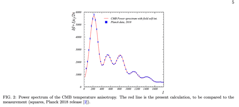

Deur's recently published classical paper at #1, Alexandre Deur, "Relativistic corrections to the rotation curves of disk galaxies" (April 10, 2020) (lated updated February 8, 2021 in version accepted for publication in Eur. Phys. Jour. C)., uses a mean field approximation to do the GR analysis.
Some different methodological tools were used in the working paper, A. Deur, Corey Sargent, Balša Terzić, "Significance of Gravitational Nonlinearities on the Dynamics of Disk Galaxies" (August 31, 2019, last revised January 11, 2020) (pre-print). Latest update May 18, 2020. https://arxiv.org/abs/1909.00095v3
Some key points from the body text:
The rotation curves of several disk galaxies were computed in (Deur 2009) based on Eq. (1) and using numerical lattice calculations in the static limit (Deur 2017). . . . Although based directly on the GR’s Lagrangian, the lattice approach is limited since it is computationally costly and applies only to simple geometry, limiting the study to only a few late Hubble type galaxies at one time. To study the correlation from MLS2016 over the wide range of disk galaxy morphologies, we developed two models based on: 1) the 1/r gravitational force resulting from solving Eq. (1) for a disk of axisymmetrically distributed matter; and 2) the expectation that GR field self-interaction effects cancel for spherically symmetric distributions, such as that of a bulge, restoring the familiar 1/r 2 force.
and from the appendix:
The direct calculation of the effects of field self-interaction based on Eq. (1) employs the Feynman path integral formalism solved numerically on a lattice. While the method hails from quantum field theory, it is applied in the classical limit, see (Deur 2017). The first and main step is the calculation of the potential between two essentially static (v c) sources in the non-perturbative regime. Following the foremost non-perturbative method used in QCD, we employ a lattice technique using the Metropolis algorithm, a standard Monte-Carlo method (Deur 2009, 2017). The static calculations are performed on a 3-dimensional space lattice (in contrast to the usual 4-dimensional Euclidian spacetime lattice of QCD) using the 00 component of the gravitational field ϕµν. This implies that the results are taken to their classic limit, as it will be explained below. Furthermore, the dominance of ϕ00 over the other components of the gravitational field simplifies Eq (1) in which [ϕ n∂ϕ∂ϕ] → anϕ n 00∂ϕ00∂ϕ00, with an a set of proportionality constants. One has a0 ≡ 1 and one can show that a1 = 1 (Deur 2017).
