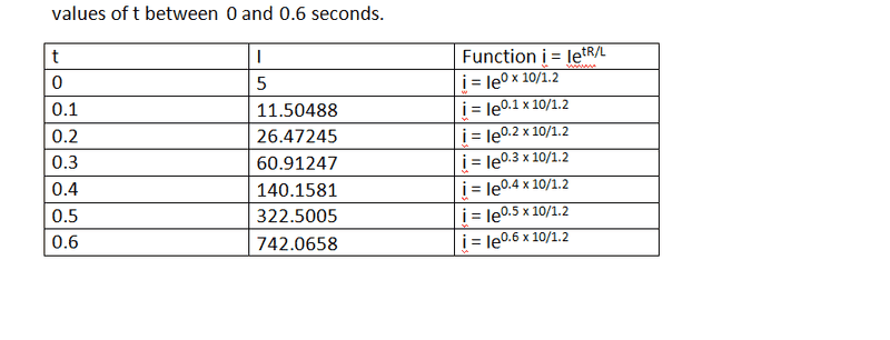

(a) For a coil of resistance = 10Ω and Inductance 1.2 henrys through which the maximum current flowing was 5 amps, plot the graph for values of t between 0 and 0.6 seconds.
please refer to attached images.

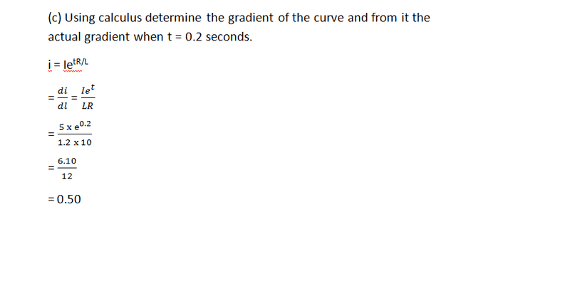

(c) Using calculus determine the gradient of the curve and from it the actual gradient when t = 0.2 seconds.
So, any help would be appreciated.

Remember when taking the derivative of an exponential, you just get an exponential with some constants out front. That might help in drawing your graph =)
Your derivative in part c is incorrect, as it was in the other problem you posted.
What is this derivative?
$$\frac{d}{dt}e^{tR/L}$$
