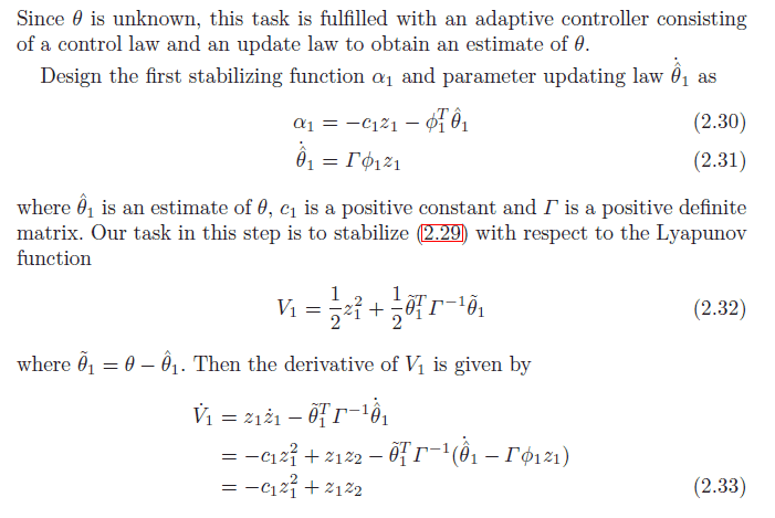

I can't seem to figure out how this next step of this derivation for equation 2.33 was produced. This is a graduate level textbook on Adaptive Backstepping.

In case my question wasnt clear enough, I don't understand how the author produced equation 2.33.
