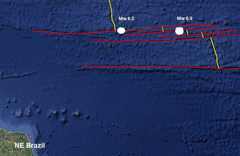

This Mw 6.9 is a bit east and on a parallel transform fault section to the Mw 6.5 that I posted around 2.5 weeks ago
It's coming in on my seismo now
http://www.sydneystormcity.com/seismograms.htm
USGS info ..
https://earthquake.usgs.gov/earthquakes/eventpage/us7000bf3k/executive
The moment tensor "beachball" shows that it isn't a pure strike-slip motion
and that there is just a little amount of oblique slip motion as well.
Satellite-style map of the mid-Atlantic seafloor off NE Brazil, with red lines marking transform fault traces and yellow lines marking ridge segments, and two white markers labeled Mw 6.5 and Mw 6.9.

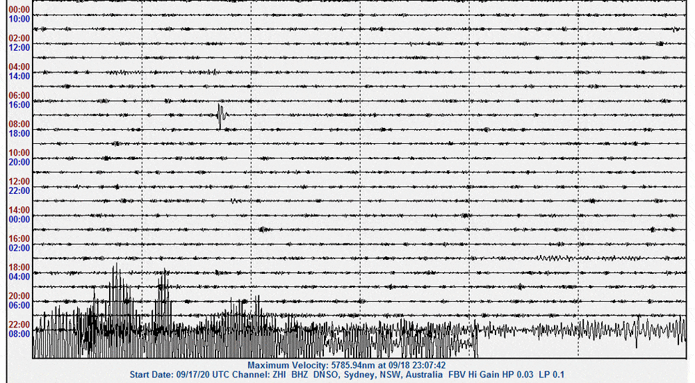

A seismogram download after about 1.5 hours of signal received
There is around 40 minutes separation between the arrival of the P wave and the arrival of the Surface waves
The surface waves continued for over an hour ( I saved the image just before the surface wave train was about to over write the
first surface wave arrival)
Seismogram trace plot in twenty-four hourly rows from 00:00 to 22:00 with dashed vertical lines; a small spike near 16:00 and a large irregular wave train at the bottom from about 22:00 onward, with a footer reading Maximum Velocity 5785.94nm at 09/18 23:07:42 and Start Date 09/17/20 UTC Channel ZHI BHZ DNSO, Sydney, NSW, Australia.
