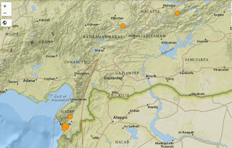

M 6.3 - 3 km SSW of Uzunbağ, Turkey​
https://earthquake.usgs.gov/earthquakes/eventpage/us6000jqcn/executive
  • 2023-02-20 17:04:29 (UTC)
  • 36.109°N 36.017°E
  • 16.0 km depth
(CNN) – A magnitude 6.3 aftershock struck southern Turkey on Monday, two weeks after a massive earthquake killed tens of thousands of people in Turkey and Syria.
The quake struck Turkey’s southern Hatay province, near the Syrian border, Turkey’s Disaster and Emergency Management Agency (AFAD) said Monday.
The United States Geological Survey (USGS) initially reported the quake as being of magnitude 6.4 at a depth of 10 kilometers before revising it down to 6.3 magnitude.
https://www.yahoo.com/news/magnitude-6-3-aftershock-rocks-143100286.html
That aftershock was accompanied by two smaller quakes of 4.2 (nearest) and 4.1 (further to the NNE). Further north were a 4.3 mag quake in Kahramanmaras province and a 4.1 mag quake in the mountains of Malatya province.
