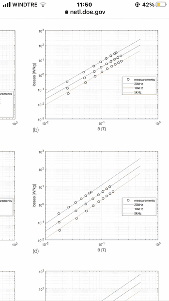

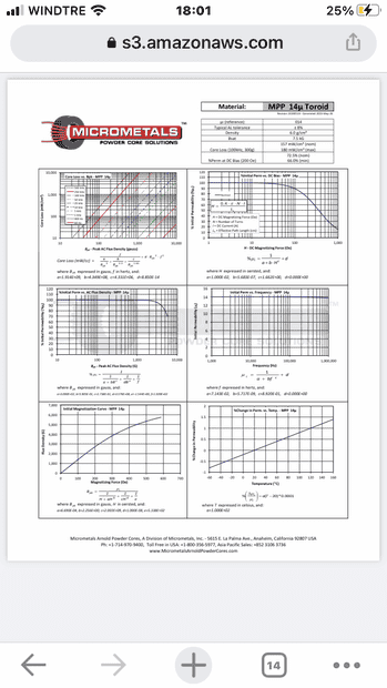

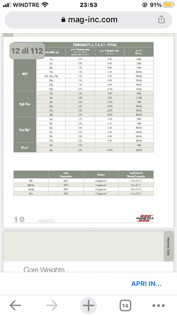

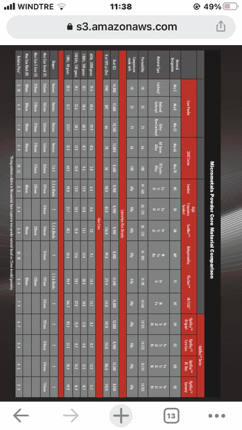

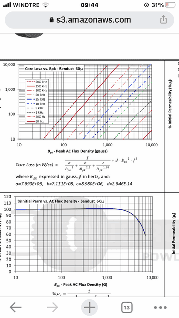

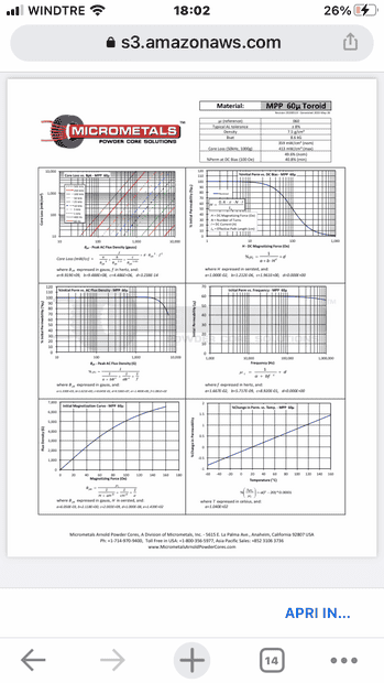

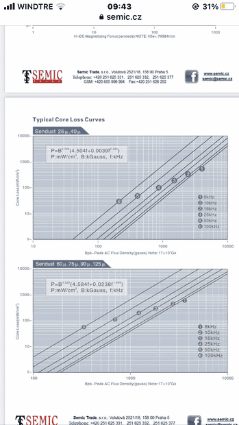

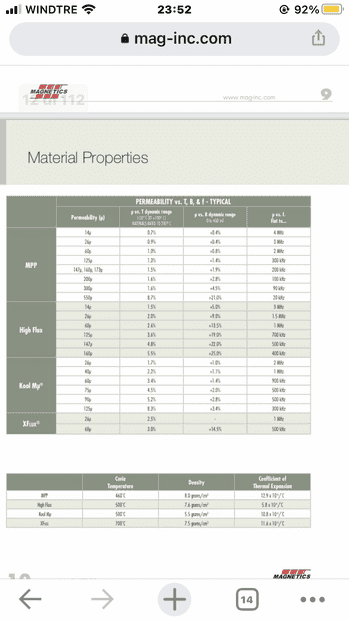

As per the title, I am unable to understand the relationship between relative permeability and frequency losses of some materials. Considering metals in powder form such as (mpp, sendust and high flux) and metglas (amorphous). Why does the density also increase in powders (mpp, sendust, high flux) as the permeability increases? Why does increasing the permeability (14, 26, 60) decrease the parasitic frequency losses? And then why does the working frequency increase at lower permeabilities. Here, to conclude, metglas has a unique permeability, namely 1,000,000, but therefore at the same frequency and field (10 khz, 1 T) does metglas have fewer losses than powders, or vice versa? My aim is to know which of all these materials has the lowest losses and is more efficient at 10 khz and 1 Tesla, or similar values. I attach images in particular of the different permeabilities of the powders
  • Micrometals MPP 60μ toroid datasheet page with a material table, core loss and permeability graphs against flux density and frequency, and a DC bias curve.
  • Micrometals datasheet page for MPP 14μ toroid material, showing a grid of graphs of core loss, permeability, DC bias and temperature characteristics.

  • Table titled Micrometals Powder Core Material Comparison listing MPP, Sendust, High Flux and other powder core materials with rows for permeability, core loss and flux density values.
  • Magnetics Inc. data table titled Material Properties, listing permeability (μ), permeability vs. T, B and f (typical) values, Curie temperature, density and coefficient of thermal expansion for MPP, High Flux, Kool Mu and XFlux powder cores.
  • Table of permeability versus frequency loss for magnetic powder cores (MPP, High Flux, Kool Mu, XFlux) listing permeability, frequency range and core loss values, with density and thermal properties below.
  • Two-panel datasheet chart for Sendust 60 mu cores: top panel plots core loss in mW/cc against peak AC flux density in gauss at frequencies from 60 Hz to 500 kHz; bottom panel plots percent initial permeability against peak AC flux density in gauss.
  • Two log-log plots of core losses in W/kg against flux density B in T, each with measurement circles and three fitted lines for 20kHz, 10kHz and 5kHz; losses rise with B across the range 10^-2 to 10^0 T.
  • Two log-log graphs titled Typical Core Loss Curves: Sendust 26u 40u (top) and Sendust 60u 75u 90u 125u (bottom), plotting core loss in mW/cm3 against Bpk peak AC flux density in gauss, with families of frequency lines from 8kHz to 100kHz and fitted power-law equations.

Analyse the skin effect depth in the material. Note the particle size.
Skin depth; d = √( (2 · r ) / ( ω · μ ) )
r = resistivity; μ = permeability; ω = angular freq = 2·π·fHz .
https://en.wikipedia.org/wiki/Skin_effect#Formula
Since; d ∝ √ 1/μ ; the highest permeability is often associated with the least skin depth.
Energy that propagates beyond skin depth is lost from the external field, to become heat.
Higher frequencies require smaller magnetic particles, separated by more of the lower density ceramic, glass or resin.
Because the air in between the metal bits has very low permeability and low density?
Because the "working frequency" is essentially defined by the losses?

Sorry, I'm too lazy to open 8 data sheet graphs, but...
1 Tesla? Really? This is news to me (again, I haven't been paying attention). Which materials can handle 1 T without saturation?
