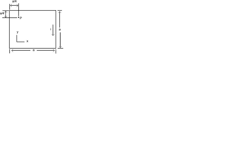

What is the magnitude and direction of magnetic field at point P shown in the figure attached if i = 10 A and a = 8.0 cm? Express the answer in vector notation.
B = \frac{\mu_0I}{2\pi d}
I'm really not sure how to approach this one... I considered using Biot-Savart for each segment of wire... but the problem is the distance r varies... furthermore, keeping the vectors separate will be pretty hairy.
Am I approaching this problem wrong? Or is it just a ludicrous amount of work?

The equation that you quoted applies only to a very long (infinite) wire. You have to use Biot-Savart, there is no other way. The four contributions all point in the same direction so the net field is the sum of the four - no need to worry about components here.
The amount of work is not ludicrous if you are systematic about it. Use Biot-Savart to calculate the magnetic field due to a wire segment of length a at arbitrary point (x, y).
For the first segment plug in x = a/4, y = 3a/4. Now imagine the loop rotated 90o clockwise. The second segment then contributes a field with x = 3a/4, y = 3a/4. Rotate two more times to get the third and fourth contributions. Add the four contributions and you are done. :wink:
I not sure what value to use for r in Biot-savart. Could I use a double integral and integrate over r as well considering that it is a changing value?
There is only one variable to integrate over. No double integral is required. Draw yourself a drawing. Put the origin at the leftmost end of the segment. Point P is at (x, y). Consider a current-carrying element ds at distance s from the origin. What is the distance from ds to P? That is your r and the only variable to integrate over is s because x and y are fixed.

scoldham said:
\hat r = <x,y>
This is not correct. The unit vector is in the direction of r which is a vector from ds to point P. As ds moves along the line segment this unit vector changes direction. First you need to express r in terms of x, y and s. Then you need to find unit vector r which is vector r divided by its magnitude.

Antiphon said:
Your first equation is correct, the correction is wrong.
Actually, neither equation is correct. Look at the drawing. Vector r has magnitude
r=\left[(s-x)^2+y^2 \right]^{1/2}
This in only one of four equations for r. Each wire segment will be done separately.
No reason for that. Please read my initial posting to this thread.
Also, express x and y as a fiction of s (parametric integral).
This is incorrect because x and y are fixed. They represent the coordinates of point P. They cnnot depend on where one places element ds.
