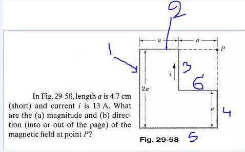

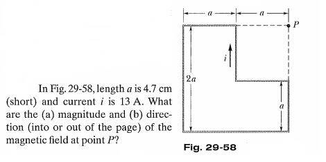

In Fig. 29-58, length a is 4.7 cm (short) and current i is 13 A. What are the (a) magnitude and (b) direction (into or out of the page) of the magnetic field at point P?
No equations from the problem
Fig. 29-58: a square-like wire loop with a notch cut from its upper right, current i upward in the left side, point P at the upper right corner, lengths labelled a, a, 2a and a.
I tried to solve the above i have one confusion here.
I have marked the areas as shown
Fig. 29-58: hand-annotated diagram of a square-like wire loop with a notch, showing segment lengths a and 2a, current i upward in one segment, and point P at the upper right, with the student's numbered segment labels 1 to 6 added in blue.
B2 = B4 = 0;
B1 , B5 Out of Page ; B3, B6 Into the Page.
B1 and B5 Calculation

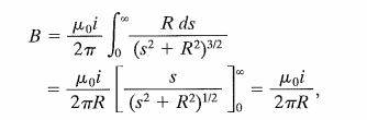

Now main doubt is regarding the B field of the finite wire let us say 1. I took the derivation of the infinite wire as below from the textbook
Equations for the magnetic field of a finite straight wire: B = (mu0 i / 2pi) times the integral from 0 to infinity of R ds over (s^2 + R^2)^(3/2), which equals (mu0 i / 2 pi R) times s over (s^2 + R^2)^(1/2) evaluated from 0 to infinity, giving mu0 i / 2 pi R.
Now instead of integrating from 0 to ∞ for 1, I integrated from 0 to 2a?
B1 = (μ *13)*[(2*a)/(2*√2*a)]/(2*π*2*a); Where R replaced with 2a
B1 = 19.5uT
Similarly for B5 = 19.5uT
Net field out B1 + B5 = 39.1uT
B3 and B6 Calculation
The same equation as above but integrated from 0 to a?
B3=B6 = (μ *13)*[a/√2*a]/(2*π*a); here i replaced R with a
B3=B6= 39.1; Net field into the paper B3+B6 = 78.2 uT
Hence the final field into the paper is = 78.2 - 39.1 = 39 uT;
I have doubts on the integrals of 0 to 2a and 0 to a is it correct? The answer is not matching it is 20uT and into the paper. Please advise.
For the infinite line you have
Equation: B = (μ0 i / 2π) ∫ from 0 to ∞ of R ds / (s² + R²)^(3/2), a magnetic field integral written in plain typeset math.
It might be better to rewrite this as ##\large B = \frac {\mu_0 i}{4 \pi}\int_{-\infty}^{\infty} \frac{R ds}{(s^2+R^2)^{3/2}}##
How would this be modified for a finite length?
