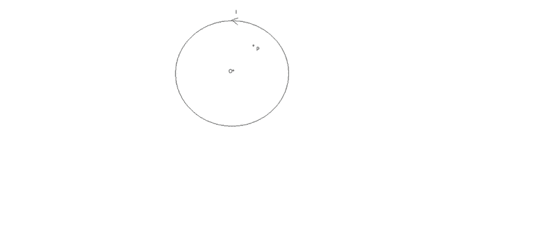

This is a question me and my friend were wondering about. How can one calculate the magnetic field due to a current carrying loop at a point in the area enclosed by the loop.
For example, at point P as shown in the attached figure.
$$B = \frac{\mu_{0}I[sin\theta_{1}-sin\theta_{2}]}{4\pi(r)}$$
I feel there are just too many variables to arrive at a solution. Even if we consider it for a point at a fixed distance $x from the center, then too the distance to the loop changes as we integrate. However, I have a feeling that analogous to the shell theorem for gravitation/electrostatics, the field should be the same at every point within the area but I can't prove it.
Use Biot-Savart law. For a general point within the loop's circumference it's indeed difficult to find a closed form expression for the magnetic field.

There is no closed-form solution. B can, aside from the center point, be only approximated. The radius of the wire is also of import. As the wire radius decreases the B field approaches infinity by the wire.

As I said, the mag field near the loop (wire) is very large, as you can see if you do Biot-Savart on a short arc of the loop very close to that arc so that most of the mag field is due to just the arc and not the rest of the loop. As the wire (not the loop) radius approaches zero the mag field approaches infinity! So no, there is no way you can rationalize that the B field is uniform within the loop area.
I know you're looking for B and not inductance L, but the two are closely related: L = Φ/i and Φ = ∫B(A) dA with i = current. I've shown that L is not exactly computable even with very advanced calculus (elliptical integrals) so it follows immediately that B(A) is in the same boat.

Have a look at this article : http://ocw.mit.edu/courses/physics/...ng-2007/class-activities/ch9sourc_b_field.pdfhttp://ocw.mit.edu/courses/physics/...ng-2007/class-activities/ch9sourc_b_field.pdf
Go to appendix 9.8(Magnetic Field off axis). Is this somehow helpful?
Look at the sentence below equation (9.8.8), and compare it to what rude man said about the elliptic integral.
Yes, obviously this is helpful as you can directly use (9.8.7) and (9.8.8) along with a computer.
