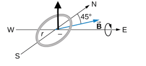

(a) A 200-turn circular loop of radius 50.0 cm is vertical, with its axis on an east-west line. A current of 100 A circulates clockwise in the loop when viewed from the east. Earth’s field here is due north, parallel to the ground, with a strength of What are the direction and magnitude of the torque on the loop? (b) Does this device have any practical applications as a motor?
Repeat the previous problem, but with the loop lying flat on the ground with its current circulating counterclockwise (when viewed from above) in a location where Earth’s field is north, but at an angle 45.0° below the horizontal and with a strength of ##6*10^-5## T. See image.
##\tau = -IABsin\theta##
I am confused about this, do the black arrows represent the direction of magnetic force?
The torque ##\tau = -IABsin\theta##, where I = current A is area of loop and B is magnetic field strength and I am a little confused how ##\theta## here is 45 degrees when the angle between the normal for the loop and the magnetic field B is 90 degrees unless I am reading the problem incorrectly?
The normal to the loop is vertical and the field is at 45° below the horizontal.
Is 45 degrees below the horizontal supposed to be pointing into the page because I thought the 45 degrees was to the right of the north line. And the normal of the loop seems to be out of the page if we curl our fingers in the direction of the current with the normal being the direction our thumb points.
I'm not sure what plane you are calling the "page".
The normal to the loop, as a vector representing the current, is straight up.
A field line through the centre of the loop lies in a vertical plane aligned NS. It angles down into the ground at 45°.

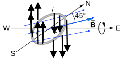

Also, are the black arrows I drew in the original post correct for the magnetic force?
annamal said:
In my image, the loop lies in the plane of N to S and E to W. That is the plane of the page. Into the page would be into and out of the page would be sticking out of the page. See the black arrow below as a representation of the normal. This normal is not at a 45 degree angle to the magnetic field but yet the theta is my torque equation is 45 degrees.
Please confirm that the drawing you have in post #5 corresponds to the last part of the problem that starts with "Repeat the previous problem ##\dots##". If that is the case, then what does the arrow encircling the E-axis signify?
One more question: The normal to the loop forms an angle of 90° with the N-axis and the N-axis forms and angle of 45° with the field. What is the angle between the field and the loop normal? What is the sine of that angle and how does it differ from the sine of 45°?
Yes, the drawing I have corresponds to the last part of the problem. I am asking about the last part of the problem as well.
I am not 100% sure that is what the problem is saying but I suspect so. I think the angle between the field and loop normal is 90 degrees, but if that is not how you read the problem, do correct me.
You have to understand that the plane containing the EW and NS axes is always tangent to the surface of the Earth and we call that the "horizontal plane". What we call "North" is in that plane and what we call "up" is perpendicular to the plane and away from the Earth. Therefore, "up" is everywhere perpendicular to "North" except perhaps at the poles. Here you have the loop normal in the "up" direction which makes the angle between the loop normal and "North" equal to 90°. The problem tells you that the magnetic field is "at an angle 45.0° below the horizontal." What is then the angle between the loop normal and the field?

That is still not completely clear. I assume you mean a horizontal plane, not a plane parallel to the Earth's axis.
The image is misleading then. If the loop is in the horizontal plane then the NS line should intersect it where it is furthest from the EW line. The picture makes it look as though the loop is tilted.
The diagram attempts to show a 3D view from some arbitrary viewing angle. The plane of the "page" is undefined. I will assume you mean the horizontal plane.
And I take that to mean the arrow is normal to the horizontal plane, so points vertically upward.
Why do you say that? The question states "Earth’s field is north, but at an angle 45.0° below the horizontal". I.e. it points down into the ground at an angle of 45° to the horizontal. If the normal is at 90° to the horizontal, and the field is at 45° to the horizontal, and both are in a vertical NS plane, what is the angle between the normal and the field?
If you are still confused about that, please post a diagram showing the view from the East as you understand it.

I drew this diagram with black arrows to determine the direction of magnetic force and torque. Is that right?
When I calculate the direction of the torque = ##\vec r \times \vec F## where ##\vec r = Rcos\theta\vec i + Rsin\theta\vec j## and ##\vec F = z\vec k##; therefore torque is ##zRsin\theta\vec i - zRcos\theta\vec j##. Is that correct?

The sign only means anything in conjunction with a handedness rule. With Fleming's Left Hand Rule the sign is positive. Does the book specify its conventions?
It is easier to remember that the torque acts so as to align the loop current vector with the magnetic field, so in this case it points West.
I am confused about that. I am pointing my fingers towards the direction of current and rolling it in the direction of B the magnetic field and my thumb points south west. So how did you get west??
Consider viewing the arrangement from the East.
The loop lies horizontal, the current vector points straight up and the field vector points diagonally down to the right. Both vectors lie in the plane of the "page" in this view.
To rotate the current vector to align with the field, you have to rotate it clockwise through 135°. Such a rotation is a vector into the page, i.e. West.

Viewing from the east, if the loop is horizontal, shouldn't the current vector be pointing to the right towards north? Can you draw a picture for me?
Perhaps I should not call it the current vector. The actual current flows around the loop, not just in one direction.
I see http://labman.phys.utk.edu/phys222core/modules/m4/Current loops.html calls it the magnetic moment of the loop current. Or you can think of it as the area vector, with the current being a scalar: http://physics.bu.edu/~duffy/semester2/c13_torque.html.
Ok I see. If the torque vector is pointing towards the west how does the current loop rotate at all since the current loop is flat.
If the torque vector points to the East then it will tend to twist the loop about an EW axis, pushing the northern edge down and the southern edge up.
