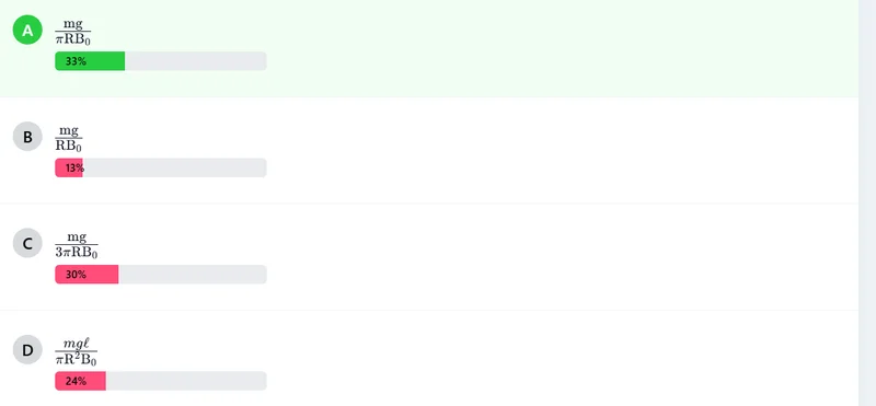

A uniform current carrying ring of mass m and radius R is connected by a massless string as shown in diagram. A uniform magnetic field Bo exists in the region to keep the ring in horizontal position, then the current in the ring is ( l length of string)

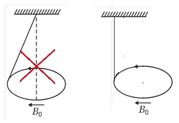

this is the diagram provided for the question

I believe the figure given in the problem statement is incorrect.
It should be as shown on the right. [Edit: Specifically, the string must be vertical.] Can you see why?

The correct drawing is as shown in post #6. There is a reason that, of all the points on the ring that one could pick for tying the string, the correct point is on the radius parallel to the magnetic field.

I also understand why the string HAS to be vertical. only if that is the case, the torque about the hinge point will be zero.

If the string is not vertical, then the string will exert a force on the ring that has a nonzero horizontal component. But there are no other horizontal forces acting on the ring. So, if the string is not vertical, there will be a nonzero net horizontal force on the ring and the ring will not stay at rest.
