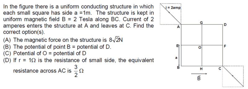

(Ans: A,B,C,D)
The magnitude of force on the structure is given by
$$|I(\vec{AC}\times \vec{B})|=I|\vec{AC}||\vec{B}|\sin(\pi/4)$$
From the question, ##I=2\,A##, ##|\vec{AC}|=2\sqrt{2}\,m## and ##|\vec{B}|=2\,T##. Hence,
$$|F|=2\times 2\sqrt{2}\times 2 \times \frac{1}{\sqrt{2}}=8\,N$$
However, this is incorrect as per the answer key.
Any help is appreciated. Thanks!

What does the answer key say?
I already stated the answers below the image. The correct choices are A,B,C,D.
The key says they are all correct? I agree with you. A seems to be off by a factor 21/2
Yes, all the options are correct. I already proved that B,C,D are correct, I was unsure about only the A option. Thanks dauto for the check! :)
